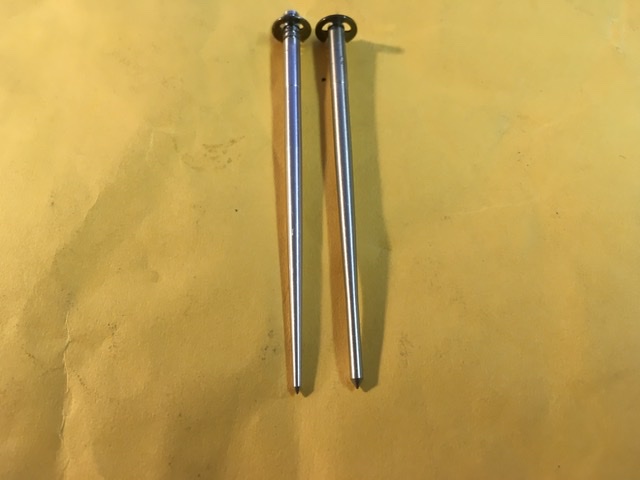

Thanks I’ll keep that in mind if I can’t get the pz30 working I’ll go with the Mikuni. I put the 112 main jet and 35 cold jet and new adjustable needle in the middle setting and it seems ok but I haven’t tried riding it yet with the changes. The new needle does have a different taper that I think would make it slightly richer at 1/4 throttle but so far seems ok.
