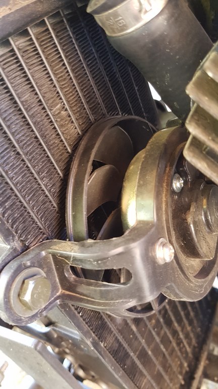

ElectricCircus 11-15-2016 06:57 PM
My advice: check both radiators!
5 Attachment(s)
Hello.
Last week I´ve found the same situation but on both radiators.
The water hoses pushed over one half of the plastic holding piece, bending it against the radiator surface.:ohno:
Left assembly:
Attachment 7784
Right assembly
Attachment 7787
On my bike (350miles only) the fan just touched slightly the right radiator surface; but at the left side it eroded the surface and two wings of the fan become broken.:doh:
Left radiator:
Attachment 7785
Left fan:
Attachment 7786
Right radiator:
Attachment 7788
2LZ 11-16-2016 09:53 AM
Not cool at all Juan Carlos. When I found my right side hitting the hose, I figured it was from me moving it all around for the valve adjustment, but you only have 350 miles on yours. My left one seems fine.
