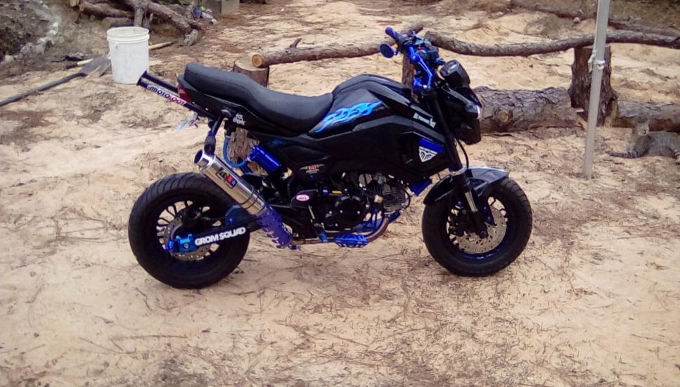

What you need to search for on Ebay is exhaust systems for Honda DAX / Monkey , the Groms exhaust flange angle is different from the chinese Grom clones and that is why a Grom system wont direct fit.
Here is a link to the stainless exhaust i used on my 2018 Venom Vader ( Baodiao /Boom 125 ) https://www.ebay.com/itm/Stainless-Steel-Exhaust-Muffler-Pipe-For-Honda-Monkey-Z50-Z50J-Bikes-Skyteam-8/162713026326
Here is another link to an alternate style, also from EBay https://www.ebay.com/itm/Racing-Stainless-Steel-Exhaust-Pipe-Honda-Monkey-Z50-Gorilla-Bike-Skyteam-z50-2/273375044647
You can see what the exhaust i used looks like :Attachment 16506
