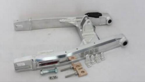

Swingarm
1 Attachment(s)
Hi,
I like the Kepspeed swingarm. They have several models. Here’s a video on YouTube on Kepspeed swingarms:
https://youtu.be/PONXd6ULiEw
I went with this model from Kepspeed
Attachment 20516
Enjoy the Ride!
