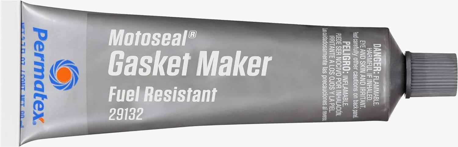

Permatex Motoseal
1 Attachment(s)
I used this stuff after removing my fuel pump for testing. Drain the tank, remove the pump and clean the area at the seal (tank) and the mating surface on the fuel pump completely. Apply a thin layer, let it dry for about 1 minute, and reinstall the pump. Do NOT overtighten those screws. They go into plastic (the tank). Just make them snug and another 1/8th turn. THis stuff needs NO GASKET (mine had no gasket, and I used no gasket to reinstall). If it has a gasket and you can rescue it, fine, but it may cause leak again if it is damaged.
