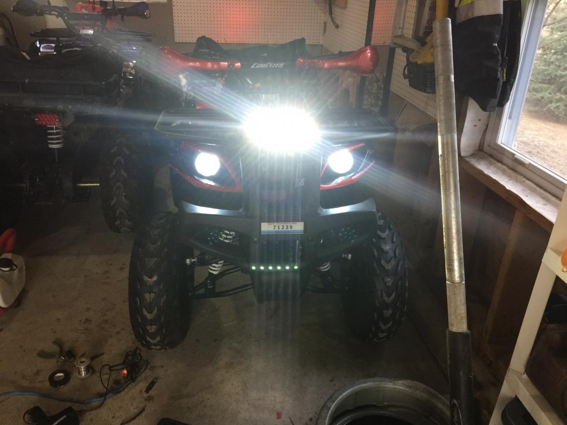

I bought two 9" led light bars from advance auto parts and installed on our coolster 150's. If your wire colors are the same, the green is ground and the blue is high beam. I just tapped power and ground at the light and the bar comes on when highbeam is selected.
