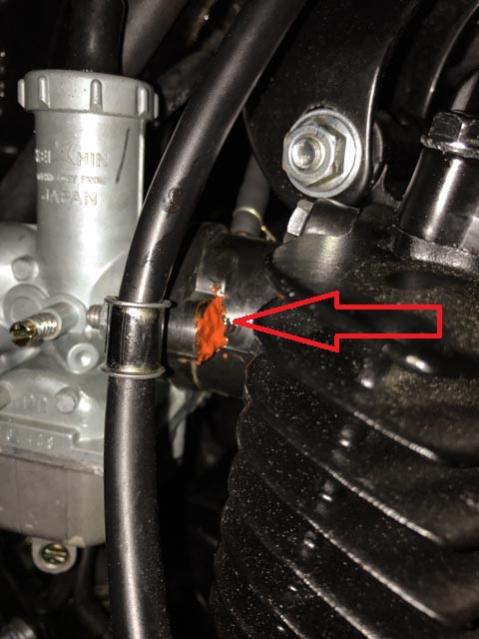

I should have taken the picture before the patch but...I was getting some popping / sputtering at idle that I couldn't shake. I discovered a hole in my flexible intake runner. I have temporally "patched" this with rtv and I'm waiting on it to dry.
Brozz owners check yours where I have mine patched. Heck, put a picture of yours here so I can see just how bad mine really was.
***Wondering if the TT250 intake is the same??***
