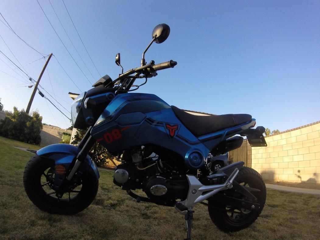

The swingarm bolt and the rear axle are Honda Grom parts, they are actually the same part and available from Honda dealers. I think I got mine from cheapcycleparts.com. They were only like 8 bucks apiece. The engine bolts were actually taped to the side of the crate my bike came in, I'm not sure if the dealer put them there or the manufacture. The carb i stole off one of my CT70's that I installed Piranha 125cc engine on, it came with the engine. The exhaust is from ebay, shipped from Thailand. https://www.ebay.com/itm/YOSHIMURA-R...tZVJ05&vxp=mtr
Made for a 2015 Grom, it didnt fit so I cut it and slipped it over the stock header pipe, actually worked out pretty good. I bought the fender eliminator kit on amazon, Vagabond fender eliminator for a 2015 Grom, bolted right on. Just had to replace the 6mm bolts with 8mm bolts. There are some vids on youtube on how to do a DYI, I wasnt really impressed with them so I shelled out 70 bucks for it, I think it was money well spent. Nice clean look and was able to use all the stock lights.
