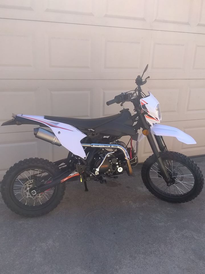

Attached is a photo. I have removed some decals and got rid of the tank plastics...they are just in the way.
