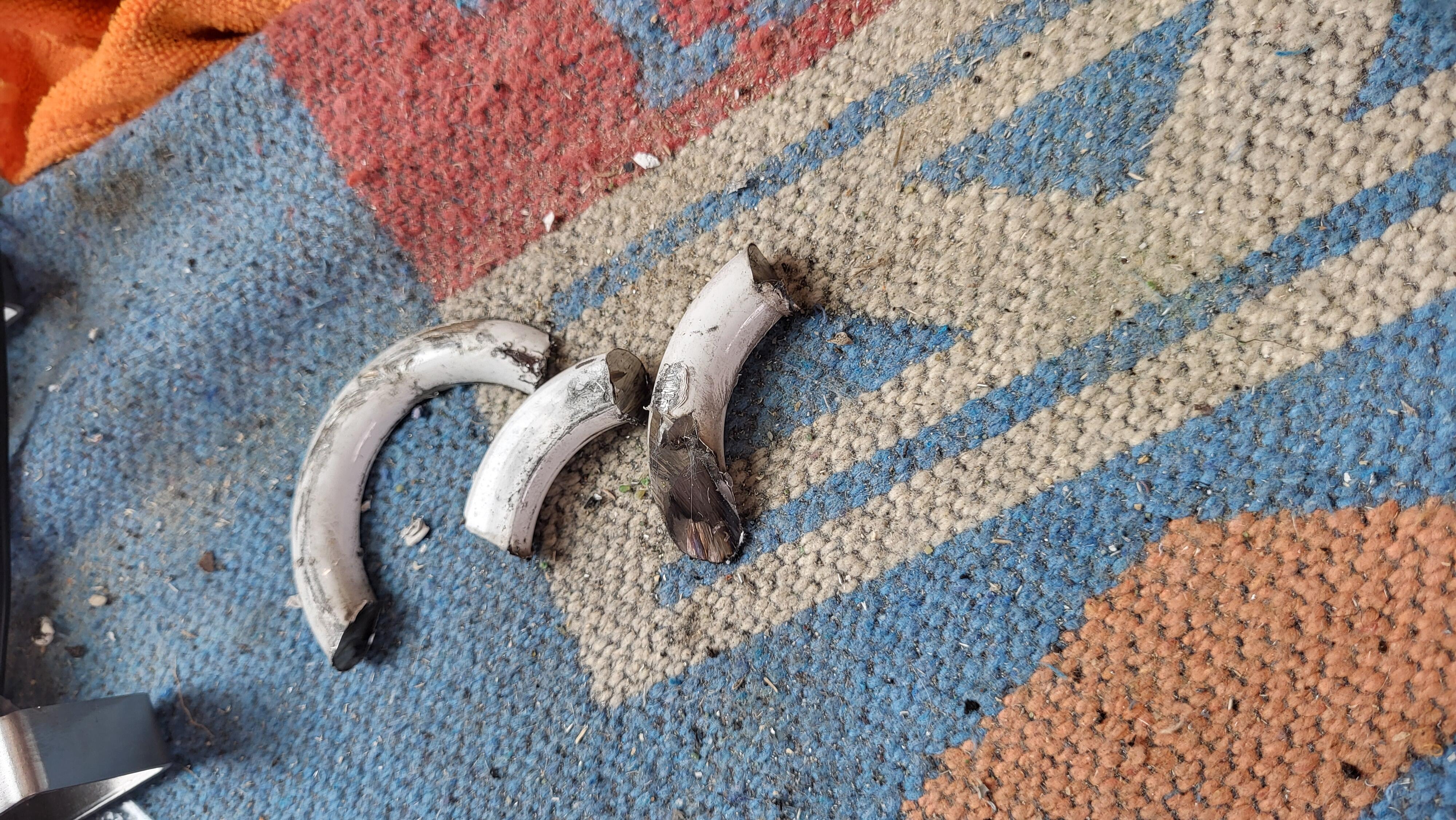

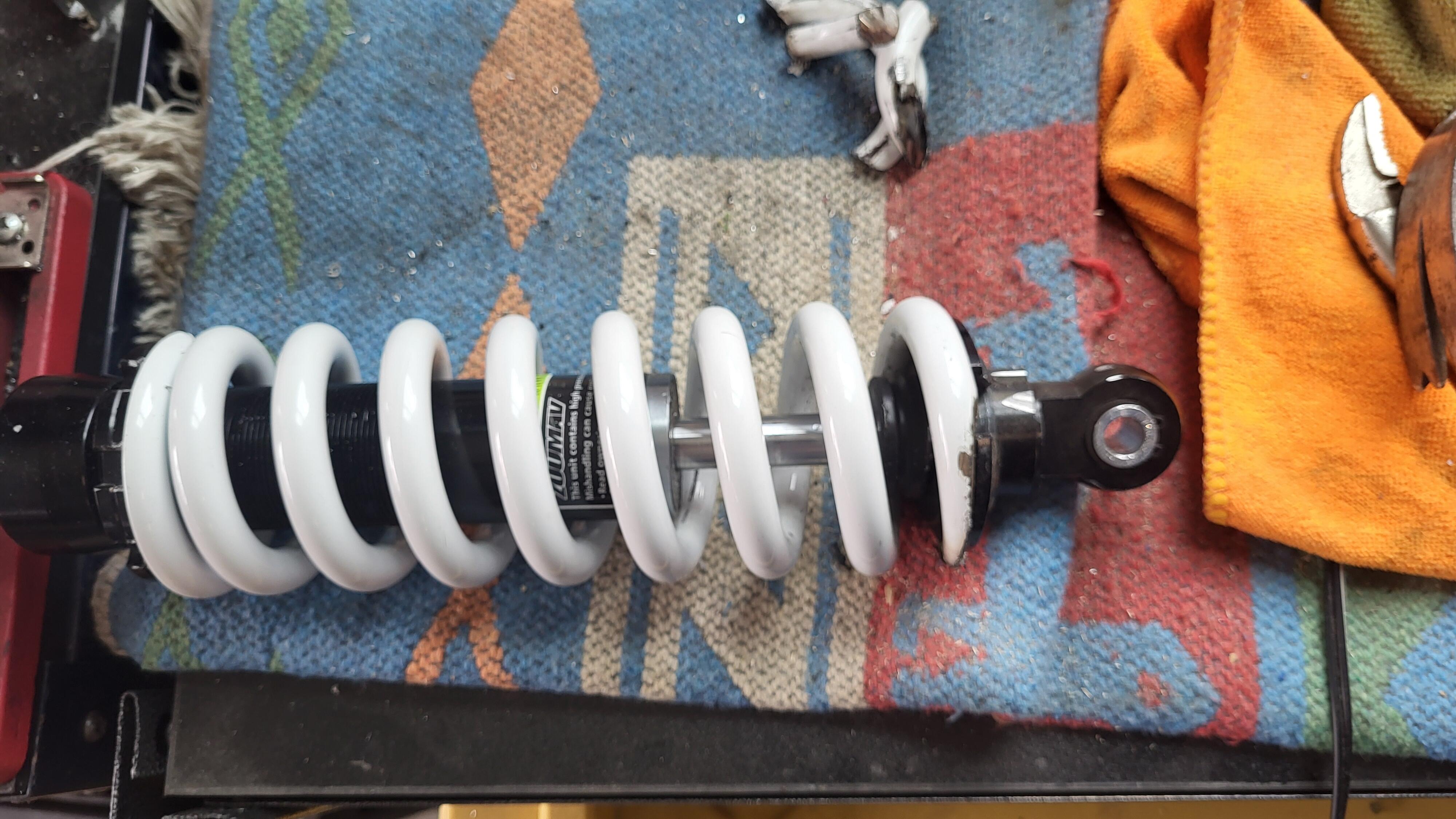

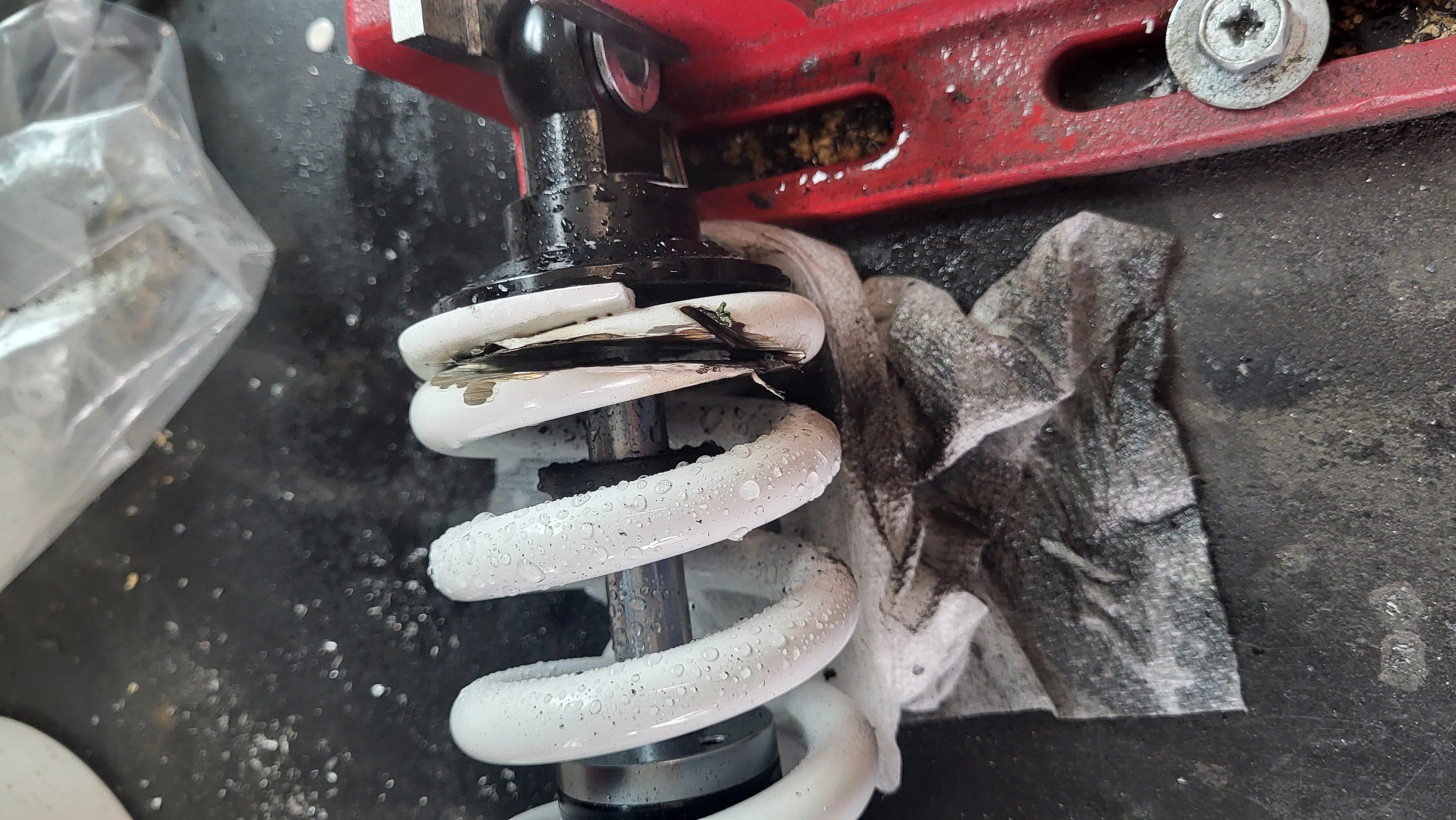

I also figured out a way to lower the seat height by cutting the spring. This is a mod I've done on another bike in the past as well and worked well. Seat height went from 35" to now at 34" which should help my daughter handle the height better.
