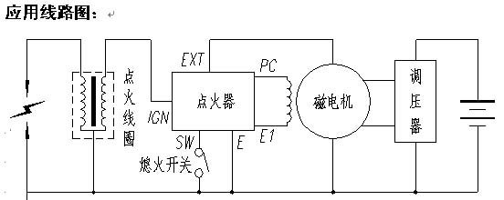

Check source coil's ohm reading. http://www.dansmc.com/electricaltesting.htm

Unplug those unnecessary. The cdi principle as #6 . The RiGHT part from alternator is NOT NEED in no battery mode.
