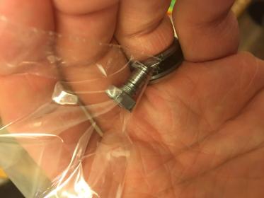

The shavings inside my oil for like small pieces of glitter. I thought I'd tear off the sprocket cover and investigate the teeth and all looked well. I decided to tighten the 2 bolts that hold on the front sprocket to see if maybe he knocking was a loose bolt on the front sprocket and the first, perfectly tightened, the second moved freely and so I loosened softly and the bolt fell out completely stripped! I can not believe this was so stripped from the factory. It has been held on by one bolt this whole time... That could've been really bad... But I will purchase a new bolt from the hardware store possibly Thursday before my trip to see if that was the issue.
On a side note, look what else came today!
Picture attached of the bolt holding on my front sprocket.

Purchasing a new bolt might not help much ,those buggered up threads have more than likely transferred to whatever they were threaded into .I guess it's pretty safe to say you did not remove ,locktite ,then tighten every fastener you could find while assembling your bike ?
