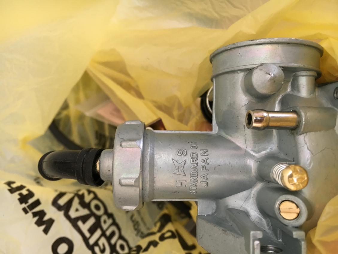

Got the carb in the mail today and the jets I ordered don't work. The markings on the carb say: H S Standard of Japan. Not sure which jet kit to get, any ideas are welcome. Name:  IMG_2202.jpg

That's a Keihin clone. Go to www.jetsrus.com and try to match up the jets from your new carb with their pics. If you find a match, you can use the part numbers they reference and search eBay.
A Mikuni might be easier to find jets for.

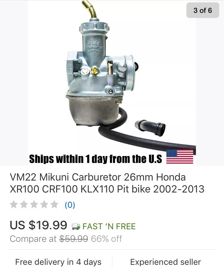

Thanks! I got this carb off eBay. The description was: vm22 Mikuni carburator. I kinda got ripped off, I should have looked closer at the pics because they do show the brand on the side..should've know that $20 was cheap for a mikuni..

I've purchased new Mikuni carbs for around the $20 mark, so those deals exist. Beware of the K symbol, if you don't want a Keihin.
Do you have a link for the carb you bought?
I couldn't find the link on eBay so I took a screen shot of the one I bought. I did find jets for the carb but they're expensive! It's almost exactly like the stock carb on my bike minus the pet cock...and obviously the jets.
