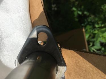

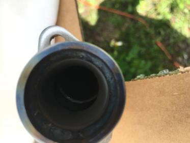

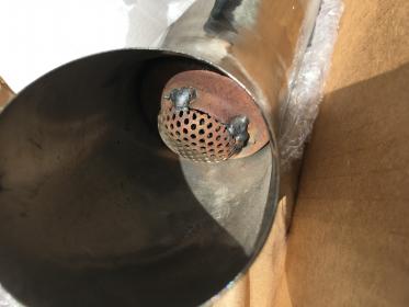

I was WRONG!
I will admit it, “I was wrong”! I paid an extra $20-30 for the Piranha name. It wasn’t worth it! The welds are not pretty. The baffling is held on with 3 spot welds. Which could be good if you want to make it a little louder. The mounting flange has two sets of holes. Like they drilled the first set, it didn’t fit, so the drilled another set. On the inlet side, when you look down the pipe, you can see a pipe blocking the exhaust flow.

The cheesy internal welds are unfortunately pretty common on the budget exhausts, but that said I can't tell if thats your exhaust flange or a mounting bracket but those double holes is plain BS, no way they didnt see that .You can likely still make it work but that's just inexcusable even for a budget exhaust .
