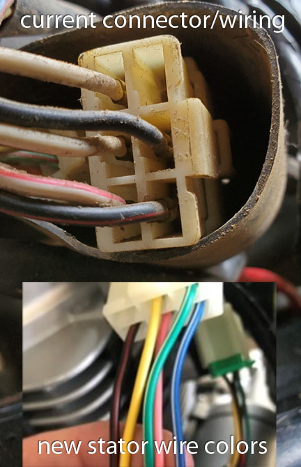

Hello,
I bought a 200cc 163fml bike from my brother. It has a new battery and spark plug but still takes for ever to start (not sure whats going on with that) and it has to be jumped because the battery isn't staying charged.
So, I figure a bad stator is the reason for it not charging. I took the cover off and oil came out (I'm assuming this is normal as there is a hole behind the flywheel where the oil comes though...see pic).
I ordered another stator and the wires are different colors than my current one. Old one has a 2 white, one white/red, black and black/red. I also attached a pic of something I found online and am hoping the wiring is correct for the new one. Any ideas on the correct placement in the connector?
Any other ideas on what going on with my bike other than the stator? Thanks for the help in advance.

Yeah, I probably didn't explain everything very clearly. It takes a few minutes of cranking with the electric start to get it going. Kick starting seems to not work regardless how many times I kick it.
I'm not happy with how long it takes to start but my main issue right now is getting the battery to stay charged so I don't have to jump it every time. The battery is not charging at all after running it for an hour ride or two ride. It's a new battery, so that shouldn't be the problem. The wiring to the stator connector has me frustrated. The wire colors of the new ones are totally different, so I thought I could compare where the wires are located on the two stators. They are in different positions, so I can't figure it out. Changing the stator out is very simple but figuring out where to place the wires in the connector has me stumped.
