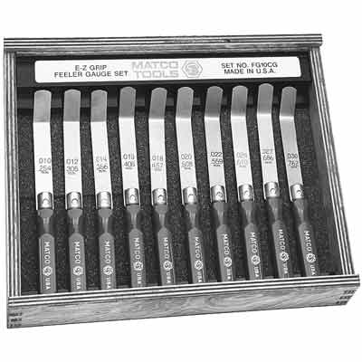

According to that number it’s a Lifan Model, not just the engine the bikes assembly as well is Lifan.
you could use this type of feeler to press the spring upward

Thanks, great info. I'll go borrow from my neighbor Gary, he has ALL the tools and gizmos. I am sure we'll come up with something that will work. I was planning on finding something to squeeze/compress the spring (like long thin pliers), but simply pushing it back up into the hole is the way to go.
Unfortunately my mechanical abilities are not inborn, they are learned one step at a time. You've shown me a much better approach to solving this dilemna
