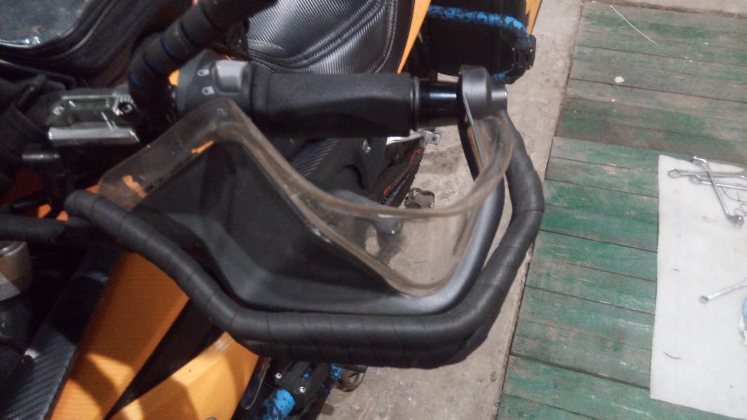

I got something like this from BMW gs from alie express and piping to keep my fingers from getting lost. It's quite large and do not freeze your hands from the wind even with thin gloves.
