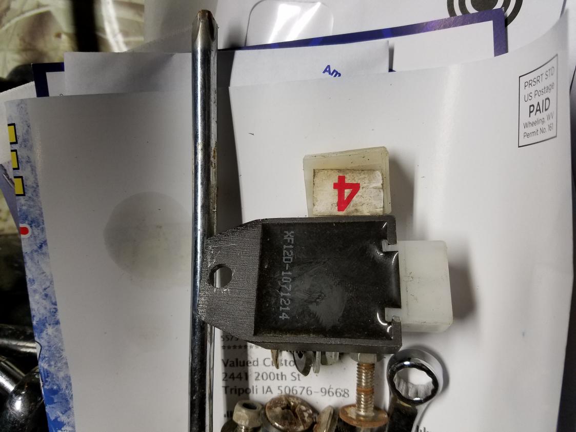

Sorry I posted in wrong forum. Can anyone tell me where these wires go into connecter? They pulled out and atv died and wont start. This is what I found. Diagrams I found show different color wires then I have. I have a black instead of the green. Is this my issue for no start?
I don't have a definitive answer, so take what I say with a grain of salt. But these mfr's don't necessarily use the same colored wires for everything every time. If I was in your shoes and I had wiring diagrams showing all the wires correctly except for one I would wire it up like that and put my extra wire in the spot that didn't correspond with a wire. Otherwise, and probably the correct thing to do, is trace the wires and see if they go to the same places as the wiring diagram shows they go.

Oh, and I don't think that in and of itself would cause a no start issue. I can run my Coolster 150's without a voltage rectifier, but it isn't a smart thing to do long-term.

I rewired and got it to start with the rectifier. Thanks for the help. This is a taotao ata110. Where is best place to buy parts? I use eBay alot but with no part numbers it's scary. Also how to I get notifications for replys?
