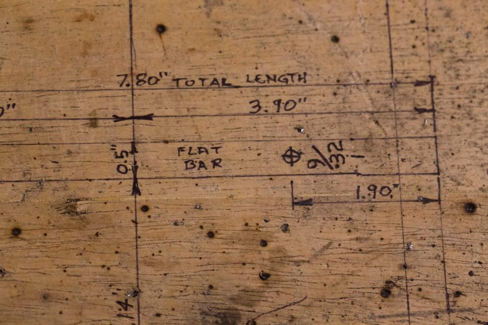

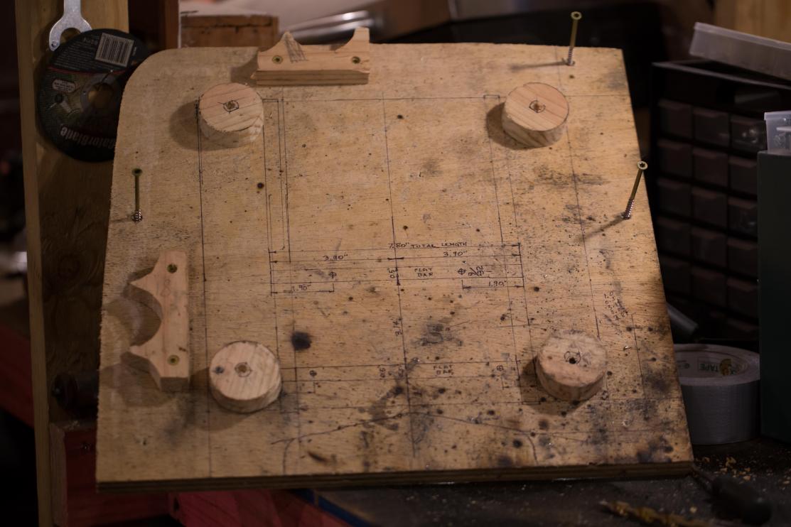

tail rack dimensions for the hawks 4 tail bolts
not sure if you can read the dimensions. i ended up using 3/4" flat bar instead of the 1/2" and should of made the corner blocks a 2" radius instead of 1" would of made the bends nicer. on corner came out perfect two corners so so and one no so good.

12" square on the inside of the exterior tubing
