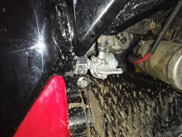

-how to use and fill the reserve tank, and will the bike die and i have to switch it over to reserve or does it just go to reserve automatically?
The little silver valve in this picture (I'm sorry that it's oriented wrong) is the answer to your question here. You can select ON, OFF, or RESERVE with this valve. There isn't actually a reserve tank. When the selector is ON, it draws fuel from the tank a little ways above the bottom of the tank. When the fuel runs so low that it's below that level, the engine will sputter and probably die. You can then turn the valve to RESERVE and it opens up a lower outlet in the tank so you have a bit more fuel to hopefully get you home. Don't forget to switch it back to ON when you fill up again, or you won't have any warning the next time you run out.
-how to find the fuel filter/air filter.
These motorcycles don't really have a fuel filter like on a car. There's a fine screen over the two outlets (ON & RESERVE) in the tank that keep the worst junk out of the carb. At the bottom of that fuel valve, there's also a little cup that screws off where water can accumulate. If you think you've gotten water in your gas, turn the valve to off, clean this out, and then turn it to RESERVE for a few seconds to drain any other bad gas/water off. Close and reinstall the cup.
