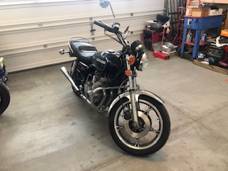

So, along the lines of "I'm not buying another motorcycle for at least a year..." and other assorted lies I tell myself, I just picked up this 1979 Suzuki GS850. For the $200 it cost me (plus the $50 I tossed the guy for gas to deliver it), I really couldn't pass it up. The carbs are off of it because they were sticking, and the guy said he rebuilt them. There's new gaskets poking out from all the mating surfaces, so I'll buy that. I just have to put everything back together and drop a battery in, and it 'should' fire right up. I'll keep everyone posted, but so far this is one of the more complete projects I've gotten myself into.

BOOM! Hooked up my jumper pack, and holy shit!, everything (mostly) works! You can tell that the contacts on the switches and such are kind of cruddy. I worked the key back and forth a few times in the ignition and it works great! There's even a gear indicator on the dash. Turn signals were a little slow, but again, the bike has been sitting for over 15 years. There's a new (six years old, but never on the road and the bike was stored in a climate controlled workshop) front tire mounted on the rim, and I also have a still new in the packaging rear tire that needs to be installed. I plan to run through the carbs today get them bench balanced and installed. I got the fuel level sending unit cleaned and working properly last night while I was tinkering. Unfortunately the fuel petcock is a disaster, and finding a rebuild kit hasn't been successful so far. I'm going to head up to the local Suzuki dealer today and see if I can get one. I plan to get as far as I can today and tomorrow, and I fully expect that I'll be able to start the bike tomorrow. I'll go and pick up a battery for the beast today too, while I'm out and about. Other than that, I'm headed back out to the garage to get some more grease under my nails.

Status Update: IT'S ALIVE! I cleaned and gapped the plugs, and dribbled a little bit of gas right down the intake ports. Gave it a quick tap on the starter button and it took right off! It revved up (higher than I would have normally liked an engine sitting that long to have revved), and promptly died. It also spit about 400 metric tons of rust out the tailpipe. Actually, that's an exaggeration for dramatic effect. It really just dusted a light smattering of very fine rust particles. The engine isn't making any expensive sounding noises (it actually sounds really, really good!), but I'm going to have to bench build those carbs and take everything apart and put it all back together to proper specs. There's so much on them that isn't in the right spot, not torqued properly, or not adjusted properly it'll just be easier to do a full on overhaul rather than try to get it running and then fix things as I go. But for right now, I certainly think I got my $200 worth!
