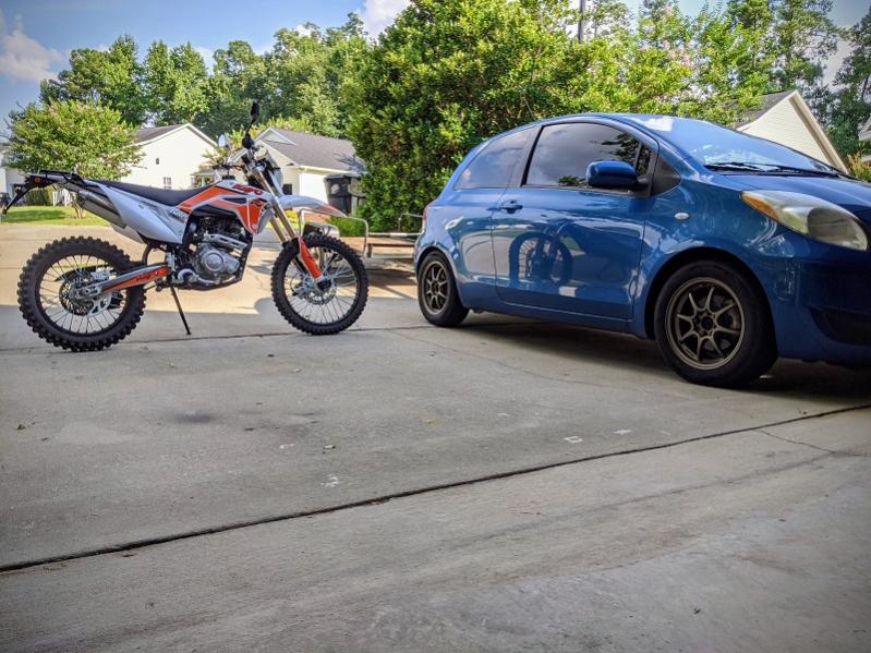

So after much debate and consideration of many different bikes, I decided on the Kayo T4! Just brought it home today from a local dealer. With taxes and them registering it etc.... $3570. I have a link to more detailed photos in another thread if interested but for now i'll attach the first 2 i've take with it home and here in my driveway.
I've already ordered an H4 led headlight bulb, handguards, and a 4 degree flywheel key from Joe Henner. Short-term plans are to modify the airbox and rejet and then go up to either a 14t or 15t front sprocket. Down the road I may end up doing the thin head gasket as well as big bore kit and cam from Joe Henner. Until then....... I'll try and report back.

Just an update....coming up on 200 miles ridden on the bike and so far so good. I've got a little 'stiction' in the front forks but that's about it. I've added handguards, USB charging port, H4 led headlight bulb, mini LED lightbar and I've also opened up the airbox a bit and rejetted to 130/42. I also have a 4degree flywheel key, 14t front sprocket, and Tusk Dsport rear tire that I've yet to install.
Took it trail riding last weekend and had a blast! loved launching out of corners and rode most of the day in 2nd gear with the occasional quick switch into 3rd. The bike pulls in all gears including 6th....and uphill. Road riding is probably what you would expect from a dirt bike....not all that smooth but i don't mind it. The rear tire(softer compound) concerns me a bit and I could feel the knobbies shifting/flexing so I order the stiffer and harder compound Tusk Dsport tire to hopefully help.(should see longer treadlife too). Looking forward to also getting my 14t front sprocket put on to help make 1st gear a little more usable and to also lower my RPM's on the road.
