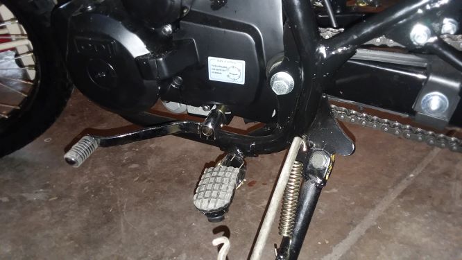

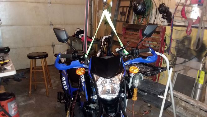

I have done stuff that make things easier to work on our bikes and am starting this thread, hoping to see, what others may have to offer. Some things may be obvious to the pro-mechanic, but this is for the less initiated. My contribution is using the "Soft Straps" as lifting devices with a ratchet hooked to the rafter and/or lag-bolt and to show the brake-spring tool that makes installing your kickstand spring a piece of cake!

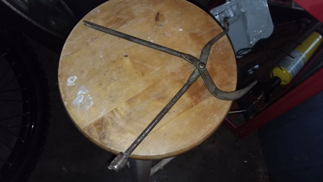

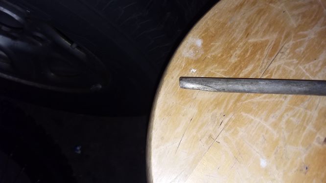

Here are some closer shots of the tool.

More importantly, is that a 1965 Corvair in your garage? Nice ideas for lifting btw. Where do you get the spring tool?

Slofun, that is a basic brake-spring tool you can get at any auto parts store or Harbor Freight. Yes...1965 Corvair Monza, I'm the snd owner and it only has 200 miles on the odometer. LOL (100,200).
