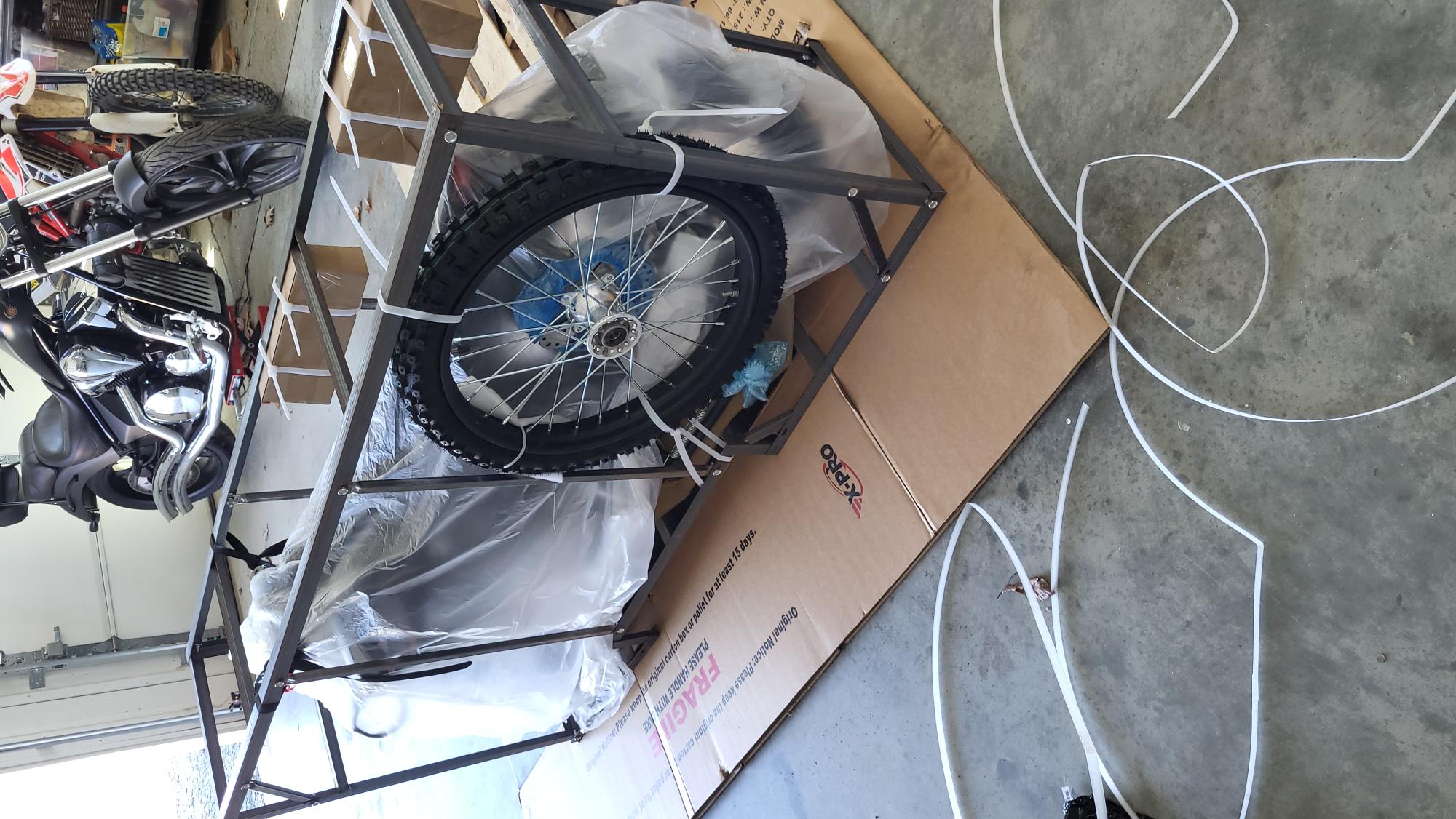

Ordering: I purchased directly from xprousa.com as it was $50 less than PSM and i found out they are affiliated companies. After placing the order i received an email as well as a link to "Shop" app that allows me to see my order as well as track the shipment. I also found out that the carrier will either b R&L or XPO. In any case, i'm hoping for the best but not ruling out the worst.
Estimated delivery time: 1 week
Update: Delivered on 3/25/24 in perfect condition, wrapped well with no issues

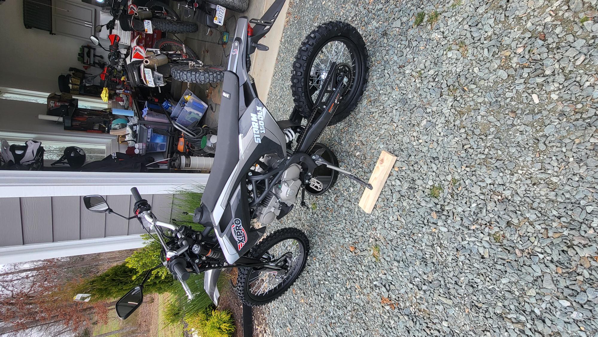

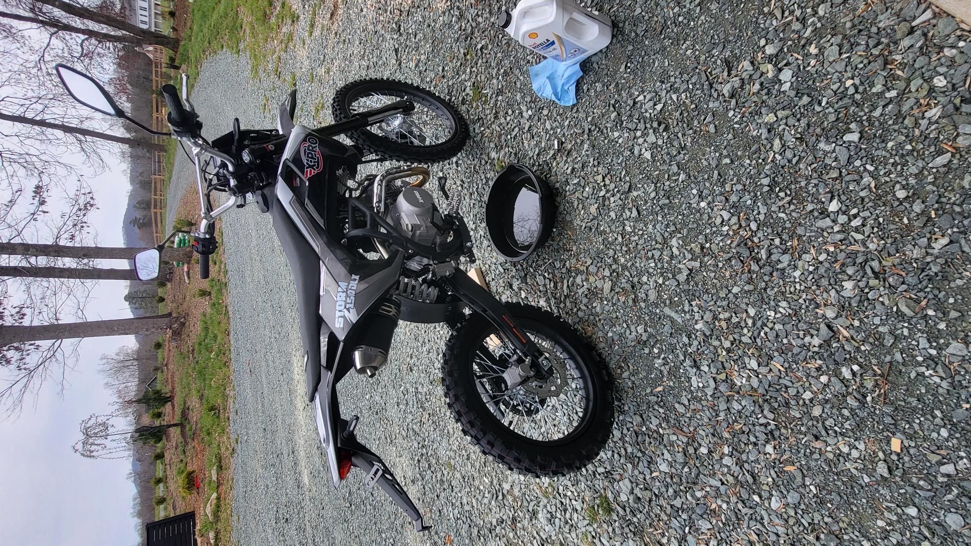

Build Day:
Time to complete: Give or take 3-4 hours, I was taking my time and applying locktite, grease and dielectric grease where applicable
Assembly: assembly is standard China bike, you uncrate, connect the rear shock, front wheel, handlebars, headlight, f/r signals, front fender and battery. There is a good YT video on assembly, I wont get into the details here.
A couple of observations: I can see that this bike had some better QA some some of the other China bikes ive bought in the past, ie. nylock fasteners, locktite marks on some of the bolts, visible grease on the neck and some other areas. They also supplied a package of grease and a complete owners manual with decent maintenance info.
I also electric tape wrapped the exposed wiring by the rear fender and applied dielectric grease to the electrical connects behind the headlight.
Post-Assembly Maintenance: I changed the shipping oil with Rotella T4 15w40. One quirk i found here is that the manual says 0.6L but wen i put that much in the oil level was at the bottom of the mark barely indicating anything. I then added another 200ml and still low. I recall my sons DBX1 was 1 qt as are most China bikes so i filled to 1Q and it was right at the top.
Post assembly mods performed: I had pre-purchased a 15 front sprocket as i want it to be able to reach 60mph ad installed it as well as a set of bark busters.
Issues of note: the gas cap doesn't secure very well.. it'll turn and get somewhat tight but can be popped off with alittle force. I may check to see what i can do about that.
I had to adjust the throttle cable and zip tie to prevent the throttle from engaging when full lock of the handlebars to the left side.
First Ride: I rode over to the local gas station about 3 miles away and was able to hit around 45mph at 8k rpm.. redline starts at 10k.. The power is fairly low but its snappy. I think its just geared too low still. I can also feel the front wheel bouncing a bit, i think its due to the wheel lock throwing it off balance.
I also spent some time teaching my daughter how to take off, stop and ride around our circle in first gear.

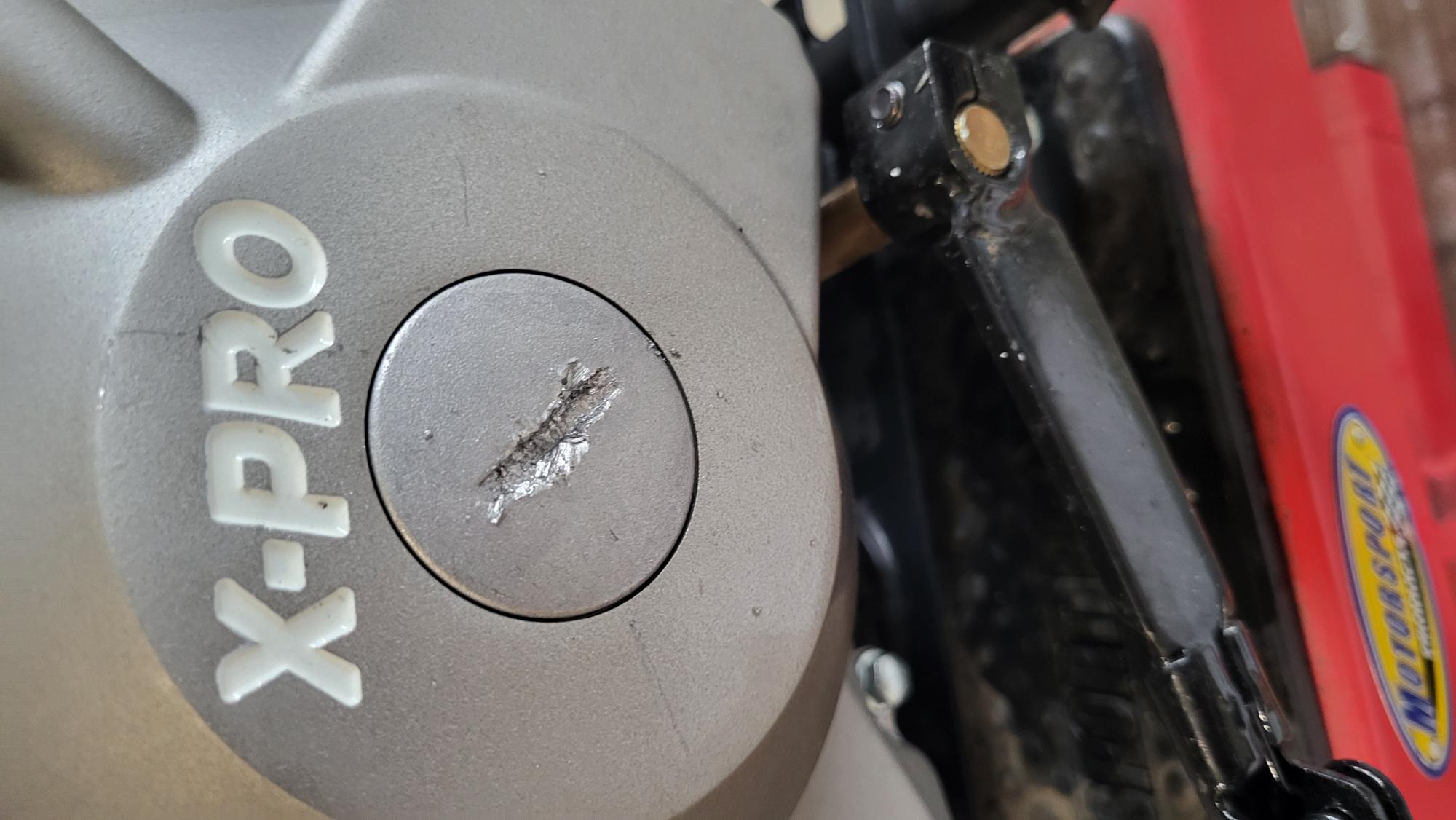

Today I adjusted the valves. The intake was at .001 and exhaust at .002 from the factory. I adjusted both to .004.
I also figured out a way to lower the seat height by cutting the spring. This is a mod I've done on another bike in the past as well and worked well. Seat height went from 35" to now at 34" which should help my daughter handle the height better.
I still need to dig into the carb as it stalls with the switch at top and runs best in the middle..probably lean
Note: it was a pita to remove the case cover port to turn the engine to TDC.. i had to apply lube and force it off.. i sent an email to Xpro and they will be sending a replacement.

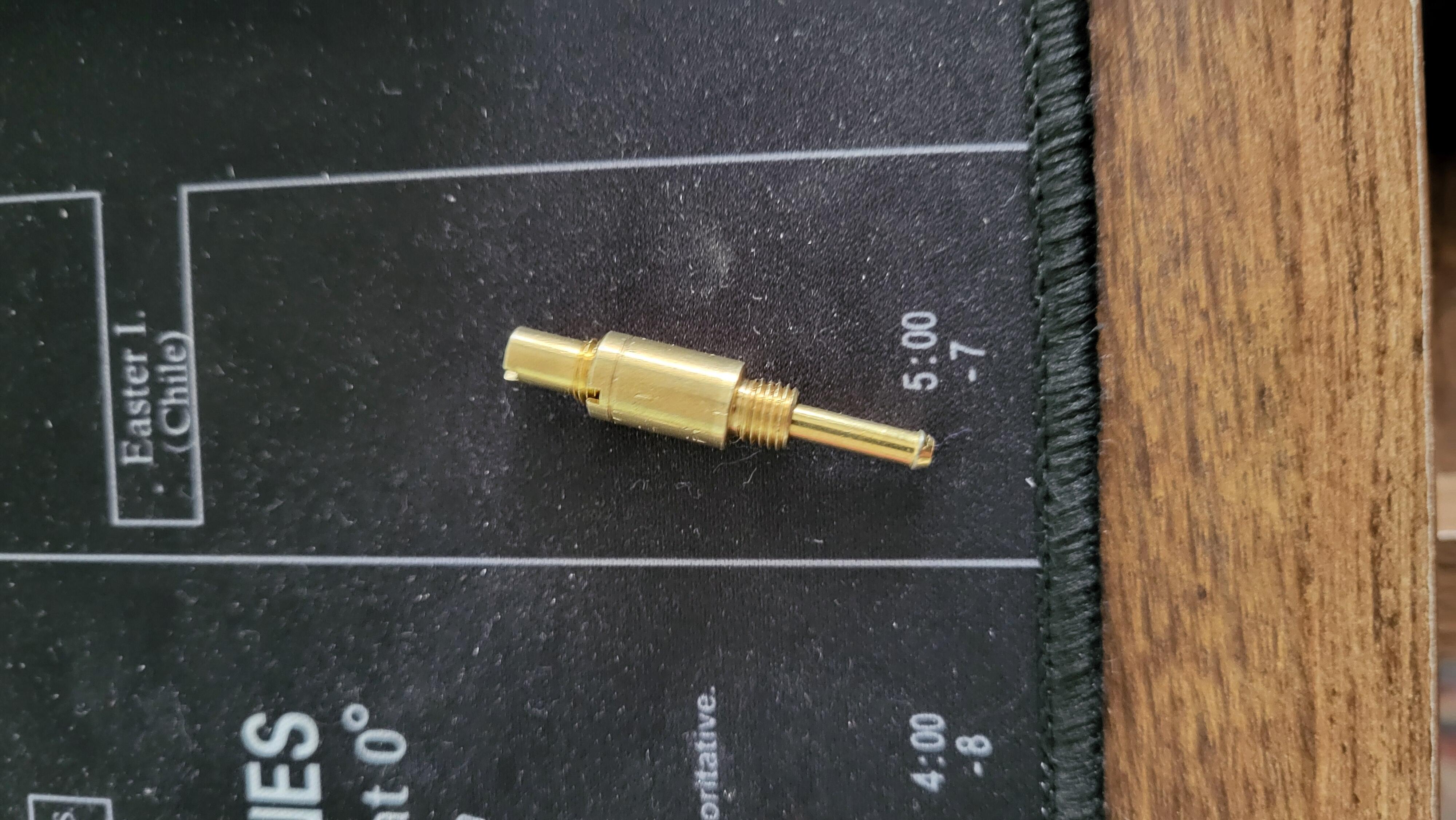

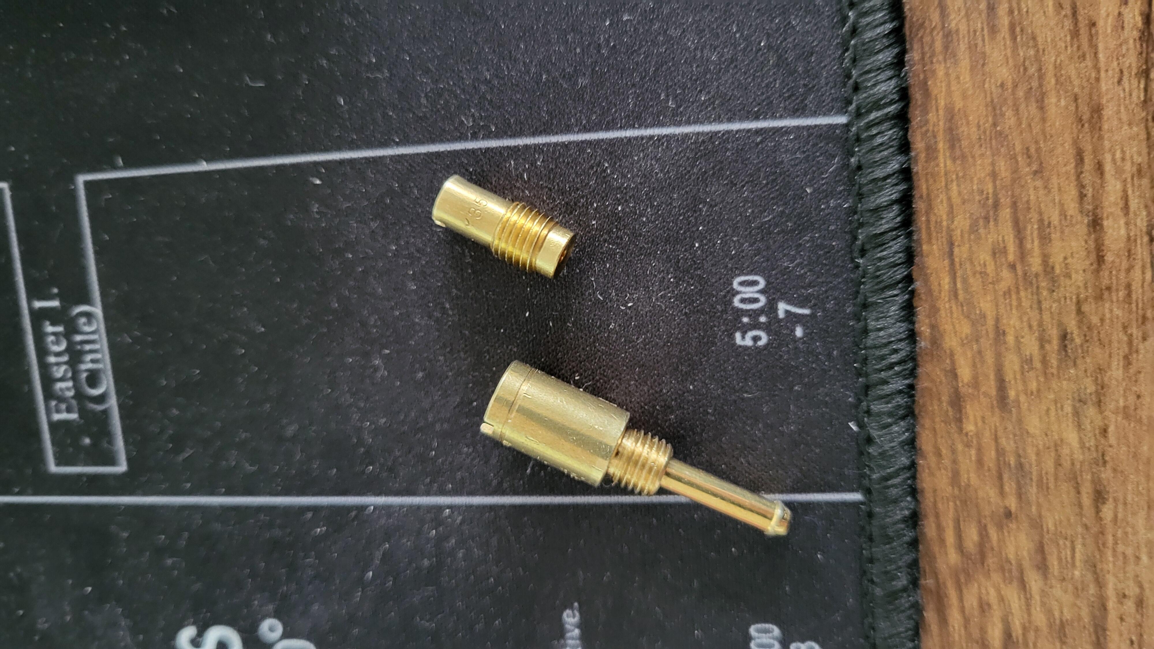

Carb day.. I removed the stock carb, swapped the main from 95 to 105, pilot from 35 to what I had on hand which was a 38. I also added a washer to shim the needle and removed the cap on the a/f screw (note: its the bottom cap not the side one).
Took a short spin and can definitely notice an increase in power, not huge, but definitely noticeable

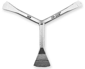

A proper timing plug tool makes the job of removing a stubborn plug much easier. They were never really meant to have a standard screwdriver used on them as the groove is curved on the bottom. See the attached picture for the Motion Pro part number of the tool if you're interested.
If you do have to resort to using a screwdriver, some fine emery cloth wrapped, gritty side out, around the tip of a nice sharp straight blade screwdriver that is just short of filling the width of the slot, and occupies about 2/3 the length of the slot, used centered in the length for a deep enough "bite", will often get it done without unduly marring the plug. That said, the proper tool is far better.
-2024 CSC TT250, stage 3 motocult kit, Nibbi PE28FL with custom-made cable controlled choke, modified stock muffler (larger diameter tailpipe), custom oil cooler installation with relocated stock evaporative emissions canister, oversized stainless steel footpegs, IMS folding tip shifter, a few little blingy bolts and bits. More personal preference mods to come.
Old 03-28-2024, 09:03 PM   #8
zero_dgz   zero_dgz is offline
Join Date: Jan 2020
Posts: 281
I just use a quarter or a big washer in a pair of pliers...
Old 03-28-2024, 09:51 PM   #9
Ive used a chisel and/or large flathead screwdriver in the past on other China bikes with no issues.. this one was jammed on real good
Old 03-29-2024, 02:47 AM   #10
Thumper   Thumper is online now
Those "wings" on the tool are dumb. They'll hit the cooling fins on the head on a cg clone (229cc) or 249cc engine (172FMM). I use a big screwdriver. But it's soft aluminum, easily damaged. And you need it tight so you don't lose it on the trail!.
I like the 10mm Allen wrench style plug on the 6speed 172FMM (249cc) rotor nut access. I wish they did that on the timing port.

How did you deal with the 2 piece pilot jet situation? Did your 38 pilot just fit in the first piece of the pilot jet (the “seat” or “housing”)?
Old 03-29-2024, 05:32 PM   #14
I replaced the the seat part if you will.. I had a YouAll carb that came from my old Templar and it also had the 2-part pilot but came with a 38 instead of the 35 that came with the Storm.. 38 is still prob on the small side but the bike is running good
