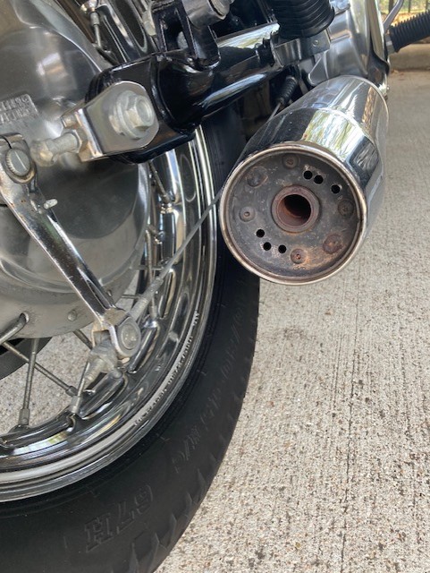

I drilled out the exhaust for a little more volume and rpm. Six 1/4" holes in the rear plate.
-The air box door came off, but the filter is still hidden and protected by the side panel.
-lastly, I jetted up from 145 to 150 main.
The air box mod made the most noticeable difference. It made the engine noise much deeper.

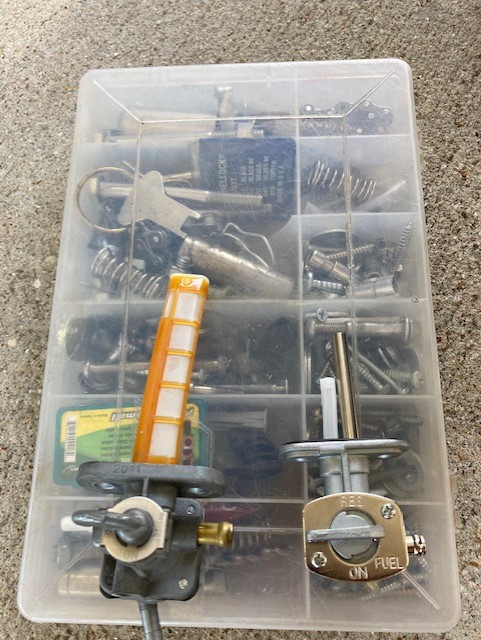

Size:  106.6 KBI did the fuel petcock change today for better reliability.
The original vacuum operated petcock is on the left.

The DRZ comes with one of those POS's. When they fail, they fill your oil with gas. Changed mine also.
Old 07-18-2022, 07:14 PM   #9
wheelbender6's Avatar
Join Date: May 2015
Location: Houston area
Posts: 1,902
Vacuum petcocks work good on my scooter, but they can be bad news on a motorcycle.

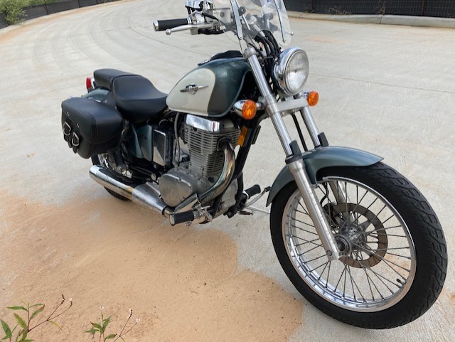

Name:  suzi free 1.jpg
Name:  suzi free 4.jpg
Size:  93.7 KBAdded some bags to help with commuting and windshield for freeway rides.
I added some luggage locks to my bags to prevent further thefts.

Old 09-07-2022, 02:18 PM   #14
Originally Posted by wheelbender6 View Post
But half of it wasn't frozen when I got home.
Top half in the wind or the bottom half above the pipe? ;-)
Ya know, the more I look at your Savage, the more I like it. SUPER clean lines and look. Very tight, uncluttered design and flow to the bike, as a unit. Not a ton of odd stuff and things sticking out in the wind.
Even the motor in the cradle doesn't even look like it's wired, or cabled. Pretty amazing, really.
