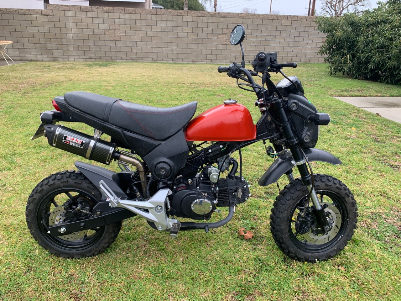

Here is what I did with my Taotao Hellcat.

is that a moped fuel tank...
seems a bit undersized....

Looks a lot like a z50 tank

With horizontal engines… downward facing exhaust will always be an issue. Something with a vertical engine - like a Kymco Space, 4 valve, 149cc, EFI, counterbalanced, would far more easily let you divert the exhaust to the side of the bike, up high - scrambler style. They’re even sold as aftermarket in Taiwan - where the bike is made and sold in masse.
