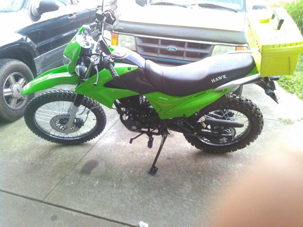

Well I've done some of the mods to hawk led lights in the cluster and tail/brake light.
I switched out the 15 tooth front sprocket to the 17 tooth sprocket ,the Mikuni carb is on its way Its in VAVA'U , TONGA in the middle of the south pacific and tonight I am going to rip the cat out of the exhaust .
Oh and already have the jet kit for the Mikuni

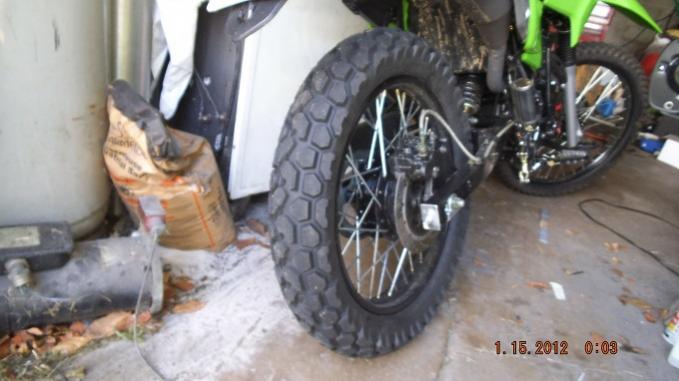

I have the VM26 Mikuni carburetor on the hawk now 110 main jet middle needle position
1 1/2 on the mixture screw what a difference no more riding around half choked .
It starts and idles on full choke for 30 seconds then to half choke for about a minute
then your off and riding .
I still have the exhaust pop when decelerating but I think that's because the cat is still in the header pipe and is probably igniting the un-burned fuel.
Also changed out the rear knobby for a Shinko 700 4.60-18 it doesn't feel like i'm riding down railroad tracks anymore much smoother on the street .

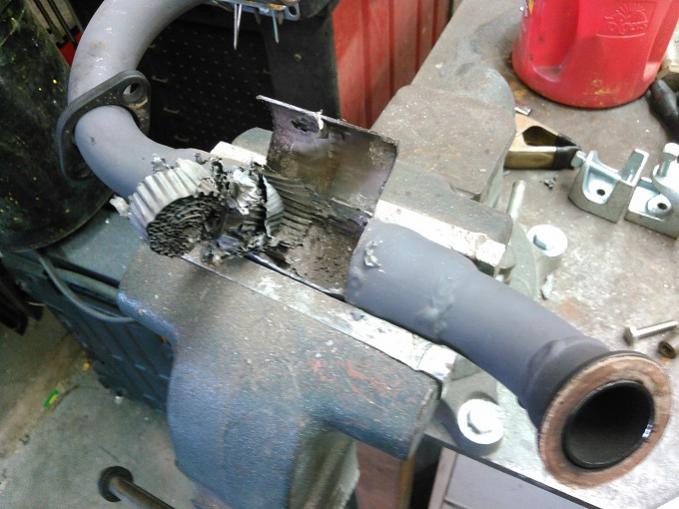

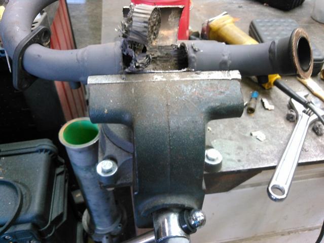

I finely cut into the catalytic converter and pulled it out it was a bit of a pain but not too bad
I cut it open with a body grinder with a cut off wheel on it which made a rather wide cut and that made welding it back up a little ruff but i got it sealed backup, if I was to do it again and i'm not I would have made the side cuts with a hack saw thinner cut I'm not going to show the welds pretty ugly lol .
I used a hole saw on a drill press to cut through material that made it pretty ez to remove the cat.
I also cut the cap off the spark arrester while I was at it.
The bike seems to run smoother and has a little more power.
