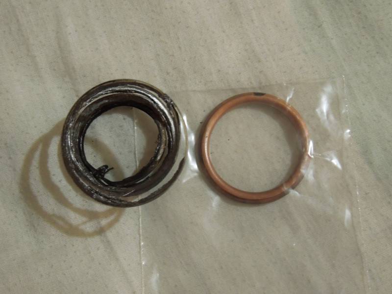

What kind of Exhaust Header Gasket was used on your HAWK?
Did it come with a good 'copper crush gasket' (right in pic) or was it similar to what I had as my header gasket (Bashan WILL)... it looked as if they used a piece of soda can metal cut like a coil/spring and smashed down to 'make a gasket' (left in pic)
I replaced that crap with a Honda OE part # 18291-MN5-650 to fix my "gasket" problem

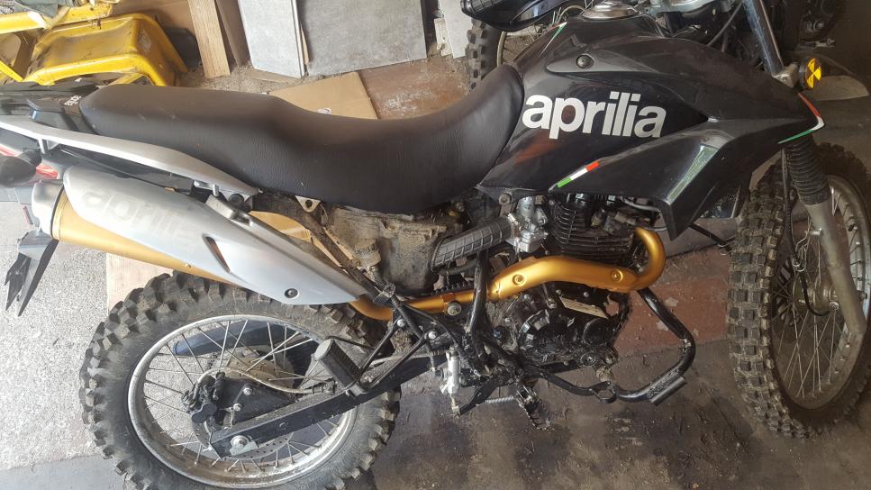

There acaully was no gasket lol, atleast non that I saw taking off. Here is a pic of it painted and on the bike
