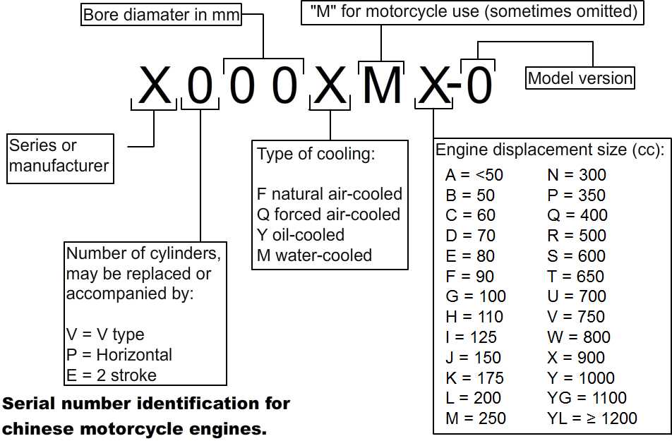

As Humanbeing and Letsride indicated, there is a stamped number on the side of the motor near the gearshift that we can interpret as displacement. Gotta get down low to see it.
The displacement is most likely to be 200, but it could also be 230. Both engines use the same electrical system and carb. As FLBoy said, a 30mm Mikuni will do the trick, and you can have one shipped to your door for around $50.00 CAD.

If you can find the numbers stamped on the crankcase this chart will help you decipher them.

So, we're still hanging around -27, working on a quad is not high on the list.
Adult machine just means you're not choking on your knee and that's two completely different types of quad.
The chart is fantastic! Thank you very much... All of you rawk!

Keep going down on the left side until you find the oil screen cover. It's got a hex head on it. To the left or right you will find the info listed in the chart to determine engine size.

This pic was just posted in another thread ... yours should look similar.. the pic might help you find the location easier.

Great job, Darth. As a side note, when cleaning the screen behind the cover, be aware the cover flange is very thin. It's very easily damaged if put back on too tight.
