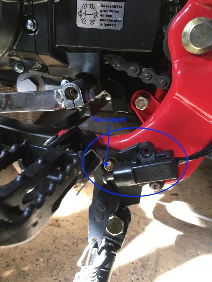

For those of you who read my last thread, you saw that I had an issue with the engine cranking, but no spark. Well here's an official ride report...
psych...
I have no idea how the bike rides yet. The tires of this bike have never touched pavement; I'm explain below.
So, there I was, tearing into the bike, trying to test everything I could to figure out why it wouldn't spark. At the end of the day, the problem had nothing to do with anything I tested or replaced (CDI, coil, plug, etc). The culprit all along was a kill switch at the kickstand. I suspect that my kickstand was tweaked during shipping. The switch itself is a mechanical "plunger" type device. It has to be fully extended (i.e., out) to allow the bike to start (see pic below). I believe the switch or kickstand might have been slightly bent a little such that it would not extend all the way out to allow the engine to spark. So, when I put kickstand up and then tried to start the bike, it disengage all the way to allow the engine to spark. By chance, I wiggled it a little while cranking, and what do you know...spark.
Then, I unbolted the top bolt that mounts the switch to the frame and tilted the switch up, to allow the plunger to extend out. This allowed for spark and the engine fired right up like nothing happened. I spent a lot of time doing a lot of testing on the bike...just to find out it was something extremely silly like this. I ended up replacing the stock CDI, coil, plug, solenoid, etc and it still worked fine and starts right up.
The good news is that all that time and work was not totally lost because I learned things I never knew before, such as CDI's, volt meters, checking for spark, etc. I didn't know much about that before, but now I do.

Unfortunately, I cannot provide any sort of update on the quality of the bike or how it rides. I can report that the starting issue I had was due to a kill switch at the kickstand.

Get rid of that stupid stand switch!
Second that!
What a stupid thing to put on a dirt bike.

sidestand switch.... another thing to go wrong... as for the tank, i would have slapped teflon tape on the bolt and sent it.... LOL

I never even thought of a sidestand switch. That is something us Hawk guys don't have to deal with. Sucks about the tank but I am glad you got it running!

Sorry I had a chuckle at this post. I've seen (and done) this so many times, we tend to always think of the worst when things go wrong. I watched my certified Mercury mechanic dad tear apart an outboard years ago when it was just a misaligned dead man switch. I always have to remember to start with the simplest most obvious first! I've also come to learn that just because it's new doesn't mean it good either (like spark plugs).
This case would have thrown me for a loop too. Generally these lock out switches (clutch, gear, kickstand) won't allow to motor to crank over. It should still work in neutral though. It sounds like this won't let you warm up the engine on the stand?
First thing I do is eliminate most of these idiot switches which usually is as simple as splicing to 2 wires together. If not that then it's the opposite.
