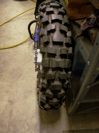

Off road and road tires have completely different needs. Dual sport tires actually do pretty well on the road, but not the best. Off road, a dual sport is designed to help you survive, and that is about the limit. The Kenda Trackmaster 2 is great off road (see post 6, above). I have similar tires, though I think my Tusk DSprot is just as good off road, similar on road (big gaps for digging, bigger blocks for strength). The Tusk DSport is not a "dual sport" tire unless you call a 90% off road oriented tire a dual sport

These tires are superior off road tires. Run them at 20psi.
A knobby will get worn out faster on pavement. So I will buy another one in a couple of years. No problem. And rain on pavement? I slow down. No biggy. Dry dirt and rocky stuff is fine for a dual sport tire, but get into mud and forget it. Soft dirt, wet dirt (even if it is not muddy), you need a knobby if you want control (especially the front tire).
