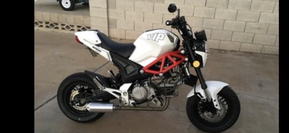

I wanted to do a quick write on a motor swap I saw online. I am not the first one to do this but just wanted to post a little info on this it is a zs190cc sold by pitster pro. engine mount bolt holes are a direct fit and the factory wiring from the CDI on the Vader will work you just have to match the same color of wires off the stator to plug from the CDI on the Vader there are 5 wires to hook up just match the colors. You do lose your gear selector on your speedometer when you do the motor swap, not a big deal the only wire that comes out of the gear selector is a neutral wire when you're in neutral on the motor it will show on the speedometer but nothing more than that. The motor does come with a carb oil cooler wiring harness and CDI. just thought I would share the info for anyone interested and doing this motor swap or want some more power to the vader!! I will post some pictures of the motor and bike for anyone you want to see what the fit looks like.

I was going to put the zs190 in my ice bear fuerza. What size sprockets are you going to be using? Top speed?

sprocket sizes are 16t and 34t rear.
I just installed this last weekend so it is not broke in yet then i will do a top speed run and re post. I will say the few miles I rode I got on it once and got to 65mph with no problem!
I do not plan on running fan for the oil cooler I will monitor engine temps and see but think it will be fine without it!

Sumter, one of the members of this forum has done this swap on his Razkull clone.

For exhausts search for Honda Dax or z50 undermount exhausts. The only key thing is that the ZS190CC has the starter on the bottom instead of at the top. You'll need to have a low enough neck to clear the starter.
Popular one that a lot of people are using is the Kepspeed Loop GP1 Exhaust.
