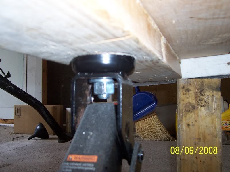

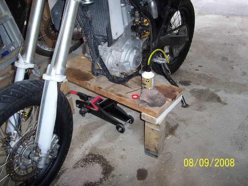

or you could be super redneck an buy a small hydralic floor jack and do this.
for the up rights you need 4x4 blocks to keep them...... upright .
total cost 20 dollars for the floorjack, "the wood was leftover from other projects."

Man, I REALLY like that idea!!

dang! that looks like the best thing I have seen so far, However, IMO I have more points on creativty
The only issue with mine is it is a little wobbly until you get the uprights in position. note: "Operate floor jack with one hand, hold bike steady with other"
