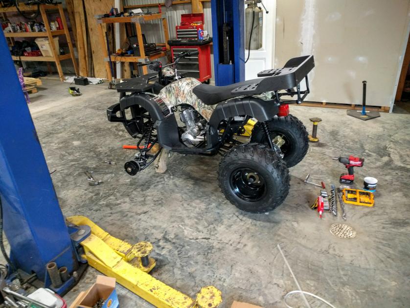

Arrived at about mmm 10:30am. Outer box was ripped pretty good and taped up. Peeked inside and seen no visible damage. And that's the first time I've seen square tires Chinese have a vacuum that sucks them down that far?
Bought a tube of blue locktite(gel). Dang that stuff ain't cheap. Thinking about installing grease zerks on the ball joints and tie rods. Anyone did this. I've watched YouTube videos of it done. I know there can't be much if any in there.
But taking my time with it, oh yea that's the funniest looking air filter contraption I've ever seen on a quad

Nice... a garage with a lift.. I'm jealous
Those foot wells tuck under the black fender trim.. they kind of pop in. Only mention it because I see you have the drill out.
Looks like a milwaukee impact gun.
Nice rig. Thanks for the pics.
Thanks Darth. Yea I was using the drill as a nut driver for loosening and tighten things up, make it quicker than a ratchet. Everything that doesn't have a poly lock nut gets a dab of blue locktite.
Used a piece of 2x12 and with the car lift, lifted it off the pallet and metal crate then support it from underneath to work on it.
Thanks Al! Yea that electric impact is a beast for sure. Rated at 1100 ft/lbs in loosening and 750 ft/lbs in tightening.

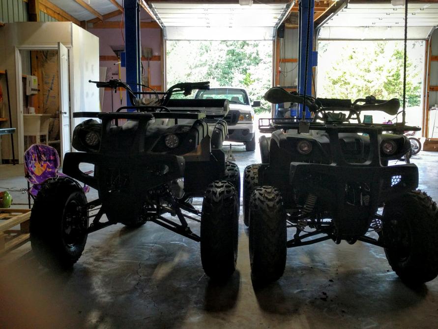

Some comparison pics of the Rhino vs the 3150DX2 from Coolster. Rhino is definitely scaled on the bigger side. Pics may not do it justice.
And 2LZ I tried reverse install on rear and didn't do a bit of good. I can easily see what you mean by crab stance . Wheel spacers will be a priority too.

Nice looking quad MizzouFan, I like the camo pattern.
Curious Question. What are the antennas on the front rack of the coolster for?
Take Care, Swampy
Thanks Swampy! Yea that's our rendition of web catchers riding on the trails I've cut out in our woods. These little orb weavers spiders like to span their webs between the tree's all over the place. They're harmless but it's real annoying riding through them as they're usually at face height while on your quad.
It freaks the kids out having a spider web and possibly the spider too on them.
