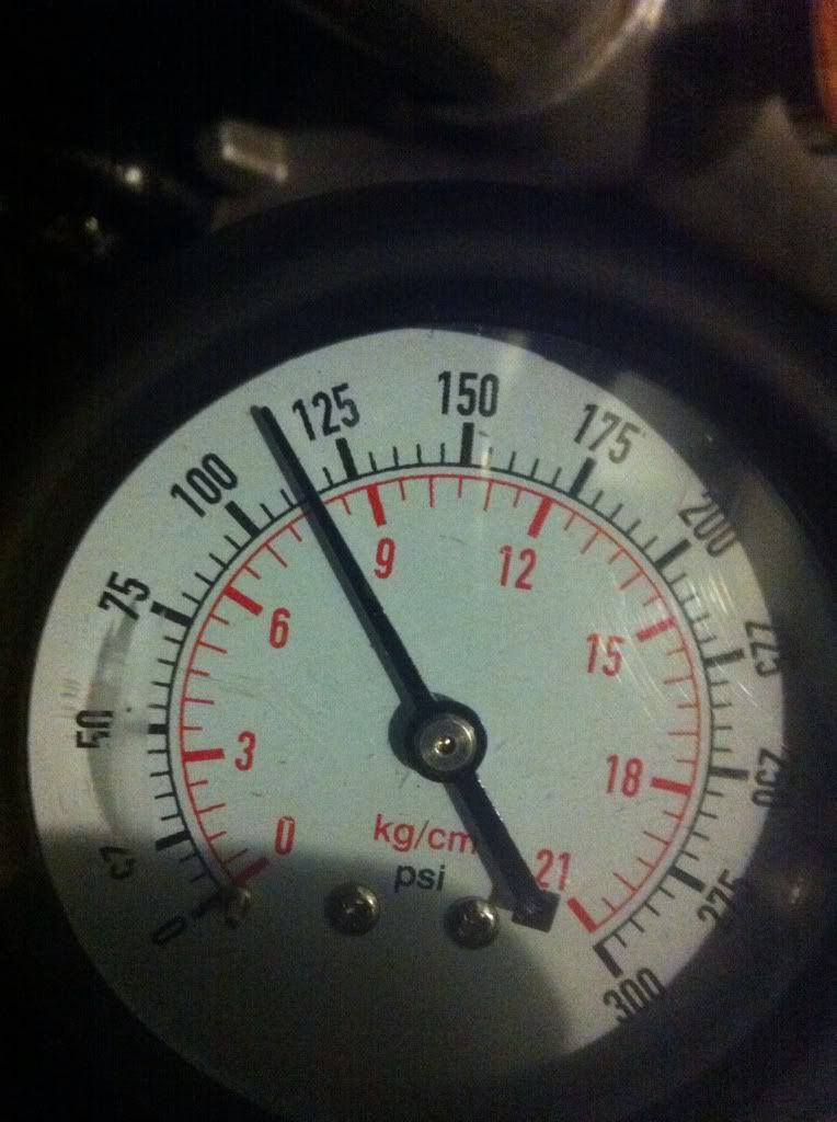

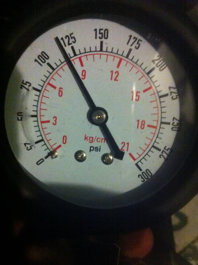

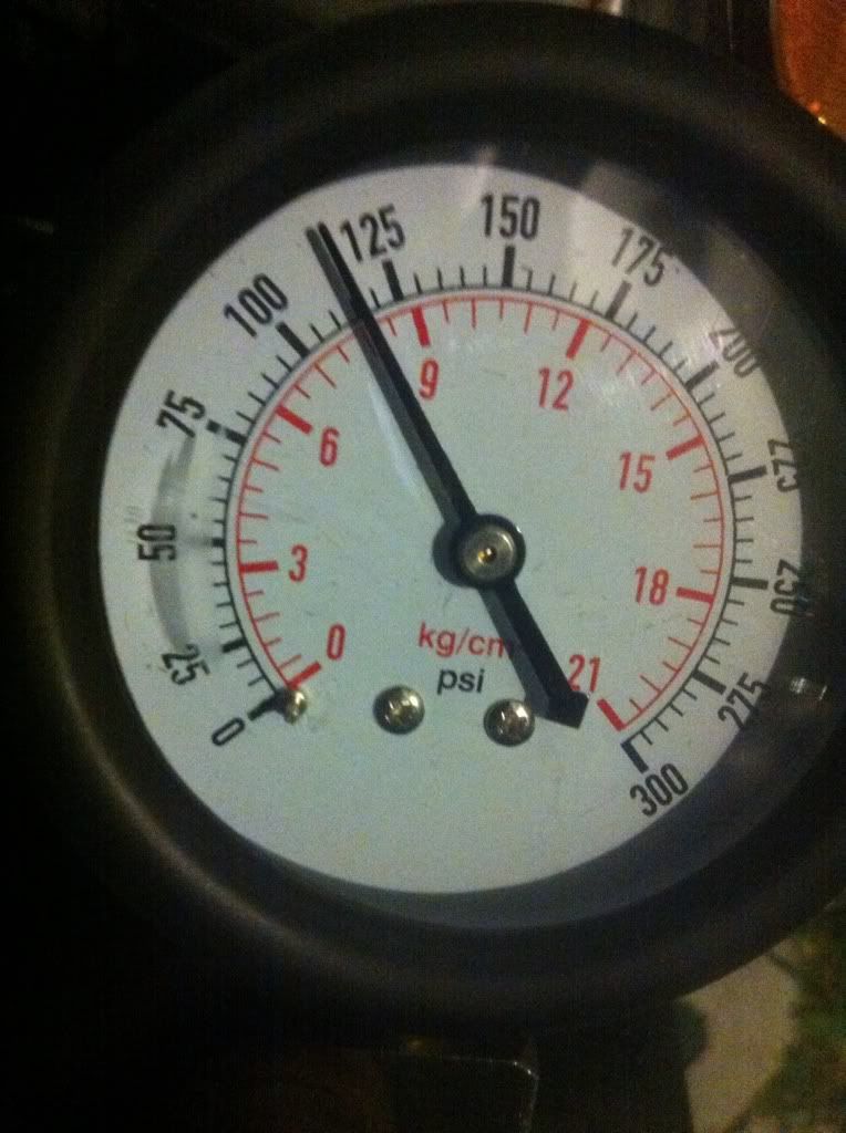

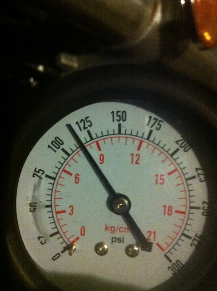

Good evening guys. Hope all is well. I finally got the correct size adapter for the compression tester and performed the test. It was performed four times and the pics above are the results. Is this good compression or do I need to check the engine now?
Thanks guys and hope to get some feed back soon. I'm desperate to be back on the road.

looks good, this also means your valve timing is correct, this narrows down the potential problems alot.
I would say its either:
the ignition timing is off via sheared flywheel woodruff key
your gas is bad or there is water in the lower part and you have switched to reserve.
since it wont start or pop on starting fluid, i would bank on there being a problem with he ignition timing.

It should run with 115psi of compression. I think its alittle low, but you are reading on a cold engine too.
http://www.dansmc.com/compression_test.htm
With the spark we saw it has to be fuel related.

Was that taken with the choke and throttle open?
I don't know Zong specs but I would think normal to be around 150.

FastDoc is correct. If measured properly with the throttle wide open, a healthly Zong engine should have compression closer to 150 psi. Pabesco's compression readings indicate one of two things. Either he didn't hold open the throttle while testing the compression, or he has compression problems.

all four times was with the throtle wide open and cranking for a total of 10 seconds each time.
i drained the gas and replaced with fresh gas also. i attempted to start it a few times and one time i heard some type of knock (only one time and loud enough to really hear), i decided to try rolling the engine again and didnt hear it again after trying to start it three more times,
if the throttle was wide open and tested with that compression then it means i will have to lift the head?
according to doc and spud this is showing bad compression? is this correct?

Even if 150 is normal it should still run well enough on 125, and it should start on 115.
According to Dan 100 PSI is the minimum. It should be 125 to 150.
Old 01-31-2013, 08:41 PM   #165
A compression reading of 117 psi at sea level for the Zong is not that great. I regularly get compression readings of 148-157 psi at 4,600 feet above sea level, with a cold engine.
The Yamaha TW200 Service Manual describes how to check the engine compression on pages 3-10 to 3-11. I suggest you read that part of the service manual, Pabesco. The service manual states the minimum compression is 114 psi, at sea level, with a warm engine. Therefore, if your compression gauge is accurate, you are barely above the minimum compression.
However, if the compression is above the minimum level, the bike should still start. You would notice reduced power while riding as the engine loses compression.
