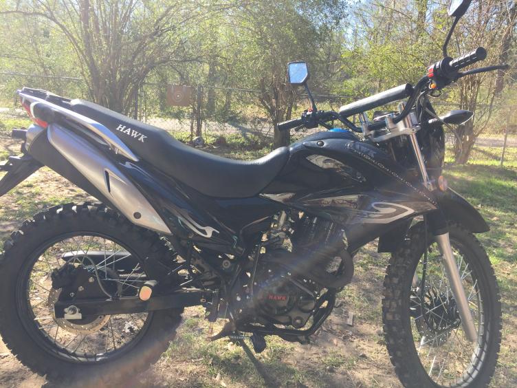

My bike
Here it is

If you haven't already, drop those forks down in the triple trees. They push the front down and slide the forks up in the trees for shipping.
Yes I did I'm also gonna be testing the handling max speed today aswell! I uploaded a picture of the forks! Raised up and also gave some input if you refresh the page when you're here it'll reload everything and then you can see all the post (new ones)
