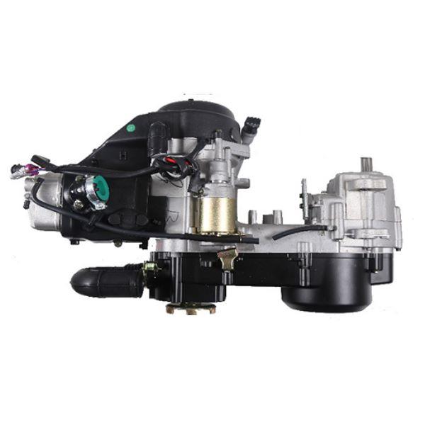

Originally Posted by kpb View Post
Hey guys! Can anyone tell me if the GY6 engines on these Bull 200 ATV's are okay for water crossings. Seems like the cooling fan would suck in water/mud/debris and plug up the works after time. Any thoughts?
I was just wondering if part 19 would work on this engine to get your air intake snorkle up some,it comes on the 170cc snowmobile engine that also has a pull start as well as electric start.It's a GY6 engine on partskit website as well as the GY6 bull engine,probably be a direct swap if anyone was needing a new motor that has pull starting.https://partskit.com/product/engine?m=110967
You'd have to watch your left foot and not get into the pull start pulley unless there is a cover with pull start in it.
