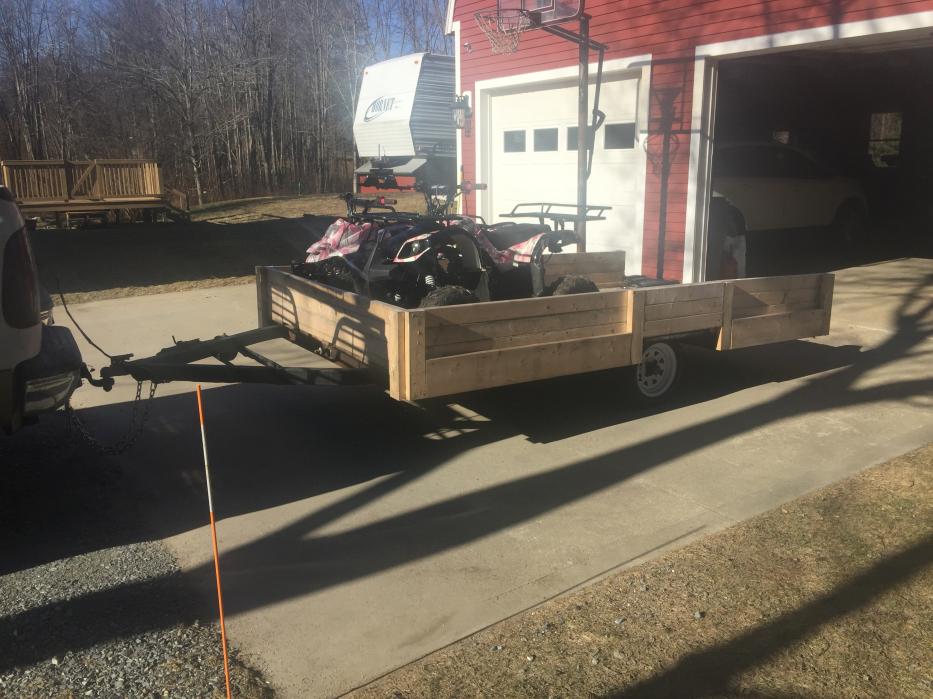

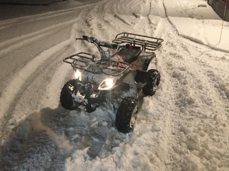

Hey everyone, first post... bought coolster 110's for my daughters 4 months ago and love them so much I bought a 150 DX2 for myself. It's being delivered tomorrow to my work! Can't wait.
How's the assembly on them? I have only found assembly videos for Tao Tao or 125's.
Looking forward to learning as much as I can on this forum.
Old 01-30-2017, 10:35 AM   #26
Love the woodwork on the trailer!
Assembly? Take your time. Some say to use locktite. Check everything for tightness. Make sure everything is adjusted properly (cables, etc...). They shotgun these things on factory assembly.
Change the oil before you even start it. The factory oil is garbage.
