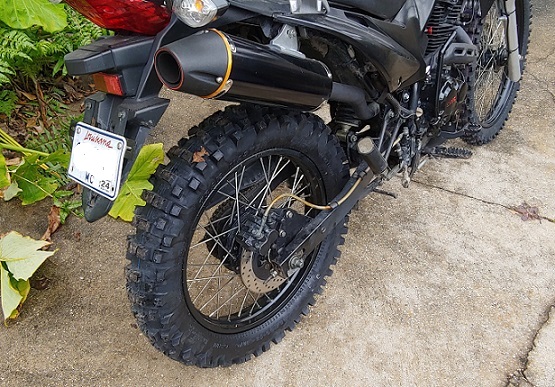

Thanks to the birthday gift from Frank AKA (oneleggedrider) I install a set of Kenda 760's and Kenda Tuff Tubes on my Hawk. I can't wait to see how they handle in the soft sand. Stock tire were a little scary in the sand. I couldn't believe how smooth they ride for such an aggressive thread on the pave.

Nice! They should dig some dirt. What size are they?

80/110-21 front and 110/100-18 rear. Same as stock but these sit a little taller. Both tires where sitting on the ground on my center stand. I had to put a piece of 3/4" plywood under the stand to get the tire off the ground so i could lube my chain.

Hi jerry, I have a 2020 tbr7. I put nobbies on my bike, both front and rear. My tires are a lil narrow then your front and rear especially the front. 70/100 for the front kenda Melville II and 100/100 for the MAXISS IT rear. Front end still feels very unstable In ANY depth of sand. I grew up riding dirt bikes on LONG ISLAND ny. Im familiar with sand! My bike is not good in sand. I see you have a brace on your forks, I tried to get one like it from WHITES? Sports, but it was a bait and switch thing. My forks are the Exact same as yours and they are VERY flexible. Im thinking that may be some of the instability im experienceing.
Keep us posted on how your new tires do. Your bike looks like it means "BUSINESS"

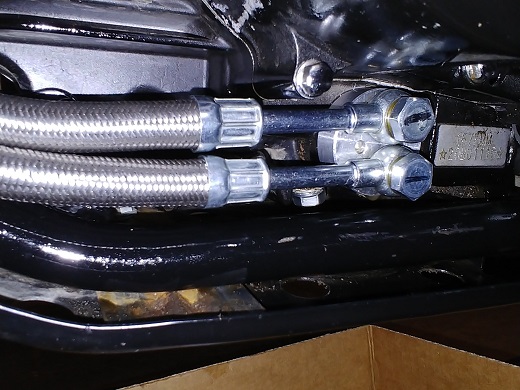

Installed the $18 oil cooler i got off of Amazon, yea buddy!
