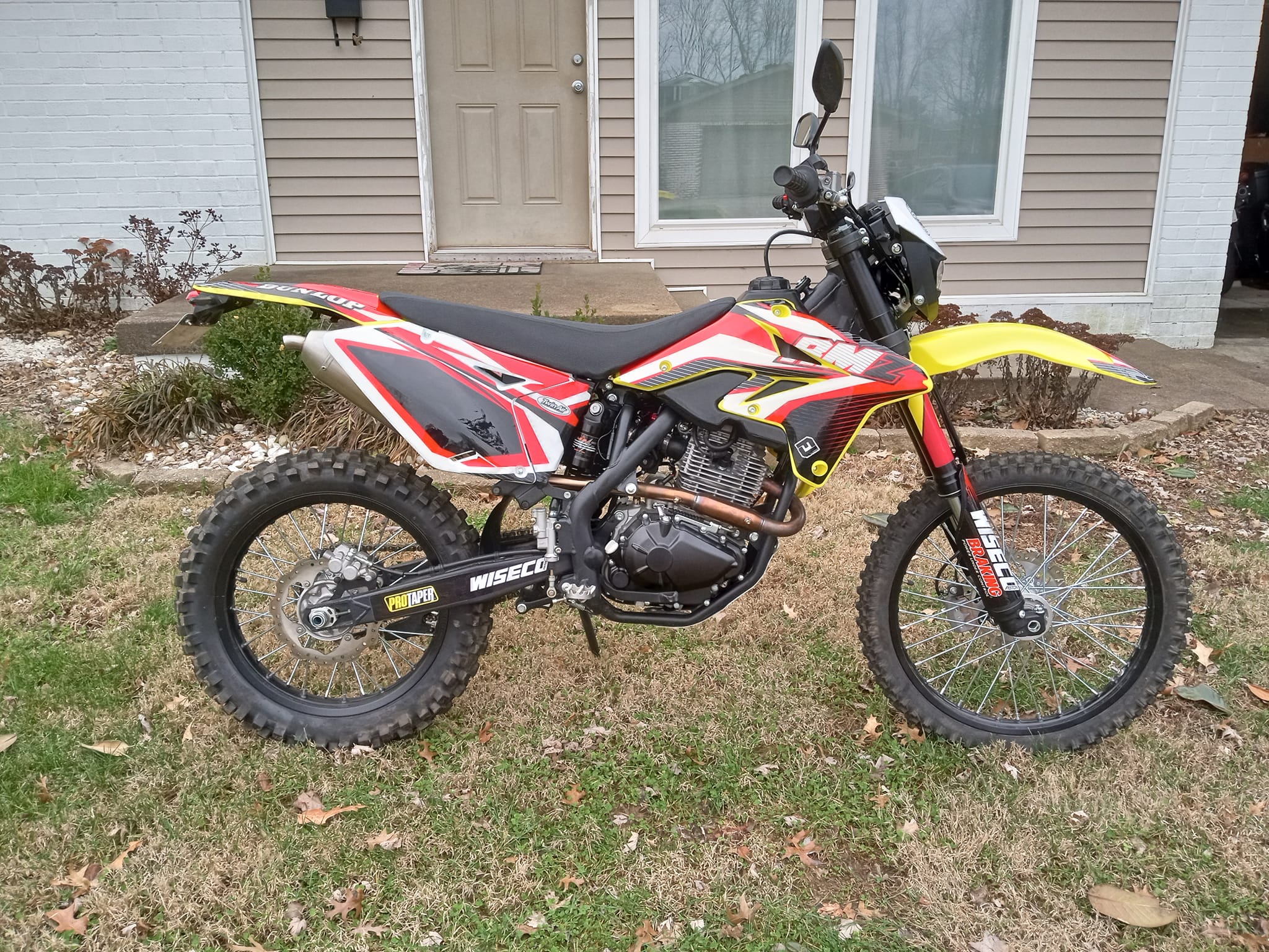

2007-2009 Suzuki RMZ250 plastics/graphics are a "go". Right side panel required a little trimming, and had to slot the holes on the side panels where the seat bolts on. But good fit otherwise. I like it!
That looks great!

Thanks! Also-the fork guards for early 2000's Honda CR/CRF motocross bikes (Showa forks) are a direct fit.

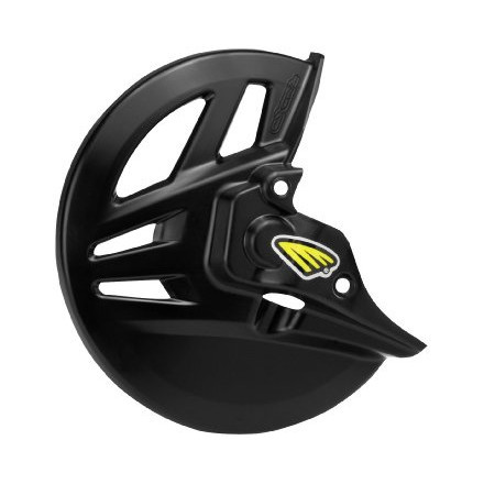

Also good to know! Do you know if there are any fork shoe protectors that fit?

Are you talking about a disk cover? These are for keeping mud out from between the pads and the rotor. Some disk protectors have integrated protection for the fork shoe, like this one.
They make 'em for the Honda CRF. Maybe someone will have to take the plunge and see if it works. Could be used disk covers on ebay for less.
I ordered a set of 07-09 RMZ 250 decals and had the logos customized for my Templar X. They fit perfectly on the plastic that came on the the Templar X. I was hoping the OEM RMZ 250 plastic would bolt right on as well. But I wasn’t sure. Until now. Thanks! Your bike looks great!
Attachment 28349
I was just talking for the bottom of the forks, but may go this route and see what happens.
