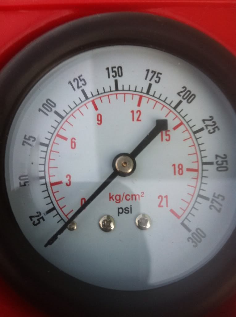

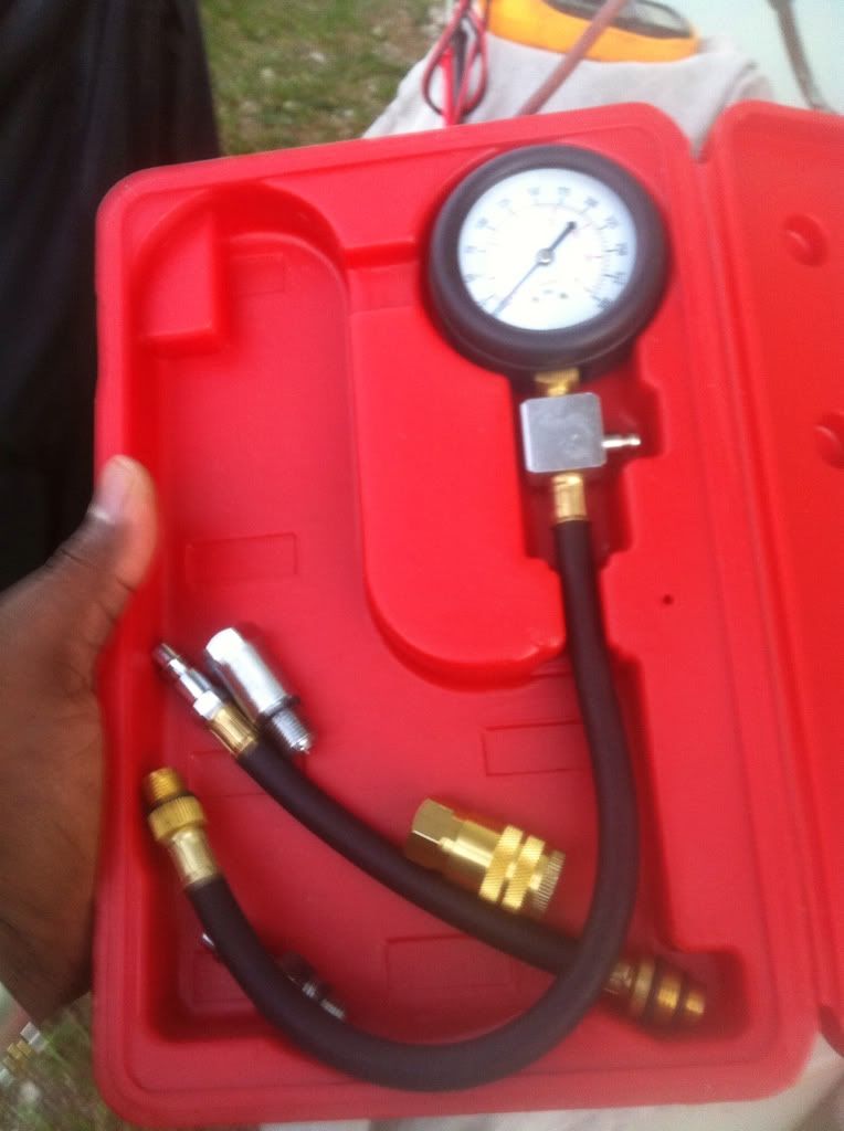

If you got a brand new carburetor, I'm confident it is in good condition. Therefore, I think you should concentrate on one task at a time, and check the compression before you do anything else.
When checking the compression, use the technique in the following thread.
http://chinariders.net/modules.php?n...ewtopic&t=7807
Leave the kill switch in the "off" position, and make sure you ground the outside electrode of the spark plug. Otherwise, you might damage your new, CDI unit! 8O
Crank the engine with the throttle wide open, otherwise you will not get the proper compression reading. Check the ambient air temperature, and let us kow how warm the day was when you conducted the compression test. Also, post a photograph of your compression tester, so we know what type it is.
Finally, conduct the compression test at least three times. Record the results, and report to us the readings. I'm not going to tell you what reading you should get. I want you to tell us each of the three compression readings you obtain.

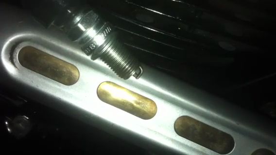

I will follow your directions and thank you for the info. I had no idea I could damage the Cdi if the plug is not grounded. Here are the pics of the compression tester and a few videos of the spark from the plug. Some in the dark and some with light.
http://i1271.photobucket.com/albums/...ps770eb57f.mp4
http://i1271.photobucket.com/albums/...psfea3d3fc.mp4
http://i1271.photobucket.com/albums/...psd9a60760.mp4
http://i1271.photobucket.com/albums/...ps7b3b00be.mp4
Hope they are clear enough

I fixed your video links for you. The third video is the only one that is easy to see, and you have a strong spark. As Spud says, hold the spark plug firmly against the head (or some other metal surface), so as to not damage the CDI.
