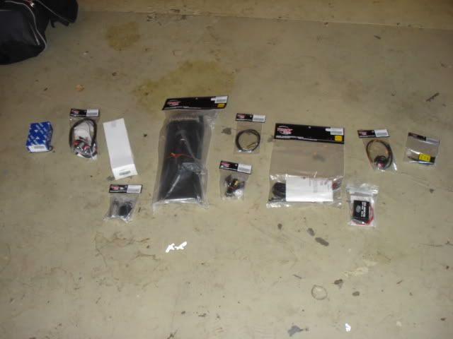

We got it done.
Nothing too hard but it took about 4 hours start to finish. Roger did most of the grunt work, I did the wiring and delicate stuff. Praise God it worked perfectly the first try.
It's a great kit, I would recommend it.

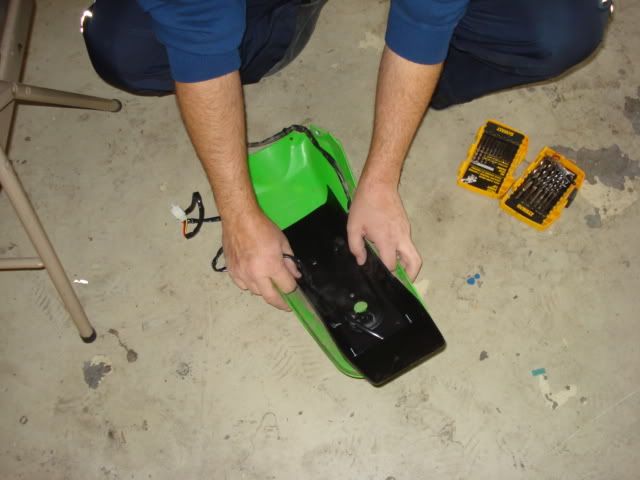

Roger fitting the inner rear fender. This was the most time consuming part of the job.
The kit layed out.

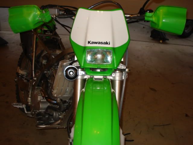

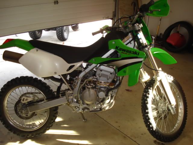

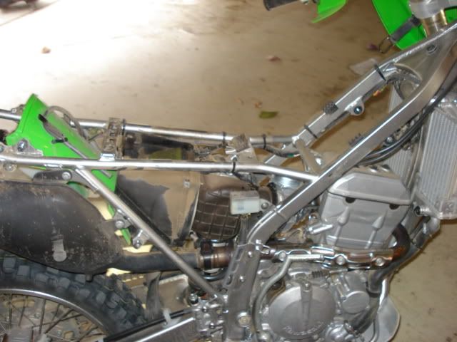

Before.

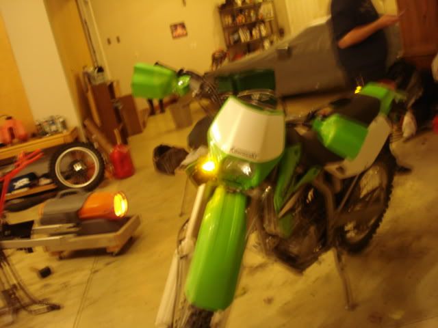

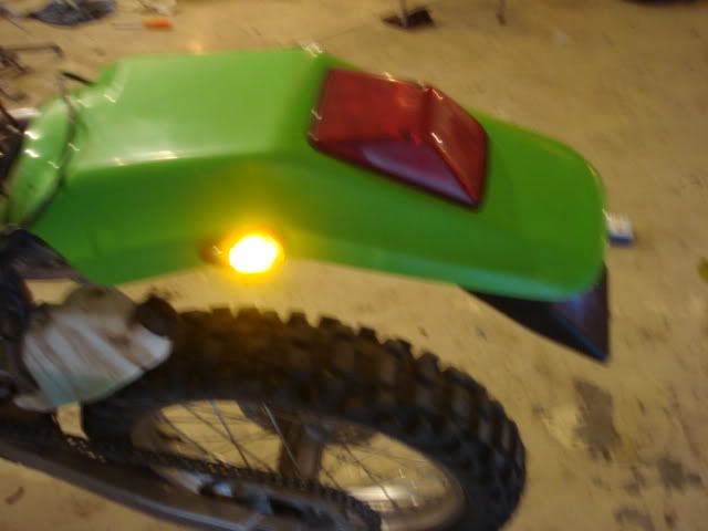

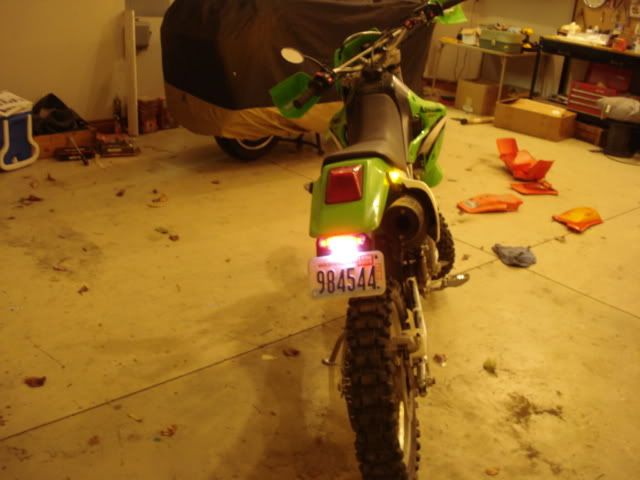

After .
The plate is not 'real'. It's just for show, an old one I had laying around.

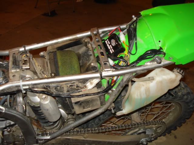

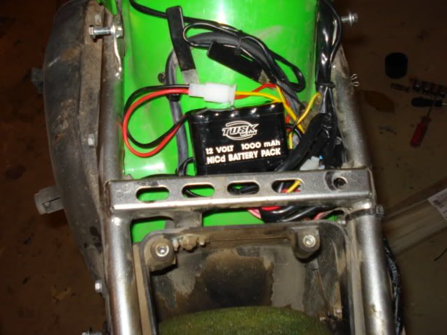

The battery and rear portion of the wiring harness.

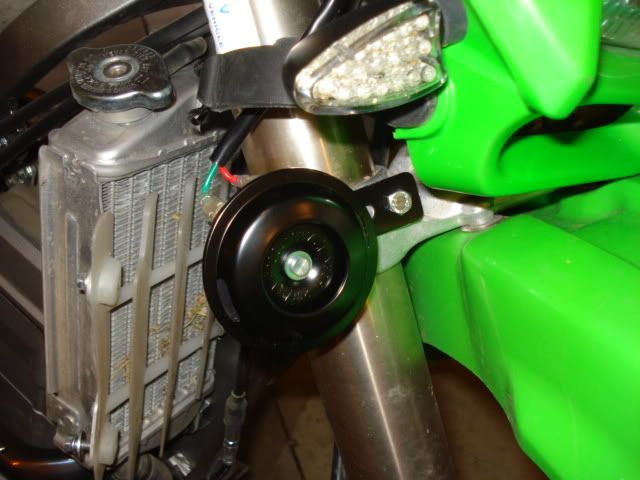

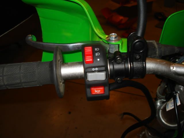

The blinkers and horn. The headlight is the original KLX's, running off the alternator, no battery. Somehow we screwed up the headlight, must have unplugged something. Will fix that later. It was too long a day to do it tonight.
Small rechargeable battery pack.
Fiddley work.

Thanks for the pics and report. The switches look good.
So, the KLX didn't already have a battery? If it did, would you be able to tap into it, rather than adding the NiCd pack?
Is the stock headlight DOT, or will Roger require a different unit for the street?
Old 11-13-2011, 07:53 PM   #3
The headlight is not DOT and lacks a high beam although that is not required per se. We're hoping the inspector won't notice, and if he does Roger will have to spring for a DOT approved Polysport, but those are not expensive.
The KLX300R lacks a battery.

Clean looking install! The blinkers are nice and compact as well, should be pretty durable when off roading. Thank you for showing us the install, Roger is a lucky man to have you for a friend and riding companion

that kit looks exactly like the kit i got from drc,,,but i had to add a acerbis d.o.t. headlight here in PA,,,,,,,my first attempt did not go so well as i tried to cheap out an not purchase the small battery pack, an for some reason it ruined my regulator,,,incendently I also installed it on a klx300.Once i ordered a new reg. and battery pack from baja designs all was well.

This system is compleatly seperate from the bikes OEM electrical system. It does not self charge, you have to plug it in between rides! Considering how it is to be used though that's fine.
The bikes stock headlight and alternator remain.
