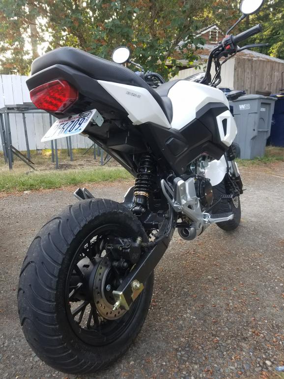

Or save yourself a ch of money and use this method like I did.
http://chinariders.net/showthread.php?t=20334

Out of curiosity, have you been flagged down for not having a light to illuminate the plate? I know that's a thing here that people get pulled over for so my zip-tie method had to include putting the plate light back on.
I have never been harassed about a lack of light for the plate. I have had a plate light that I bought years ago sitting on the shelf waiting for the first time I get popped lol.
