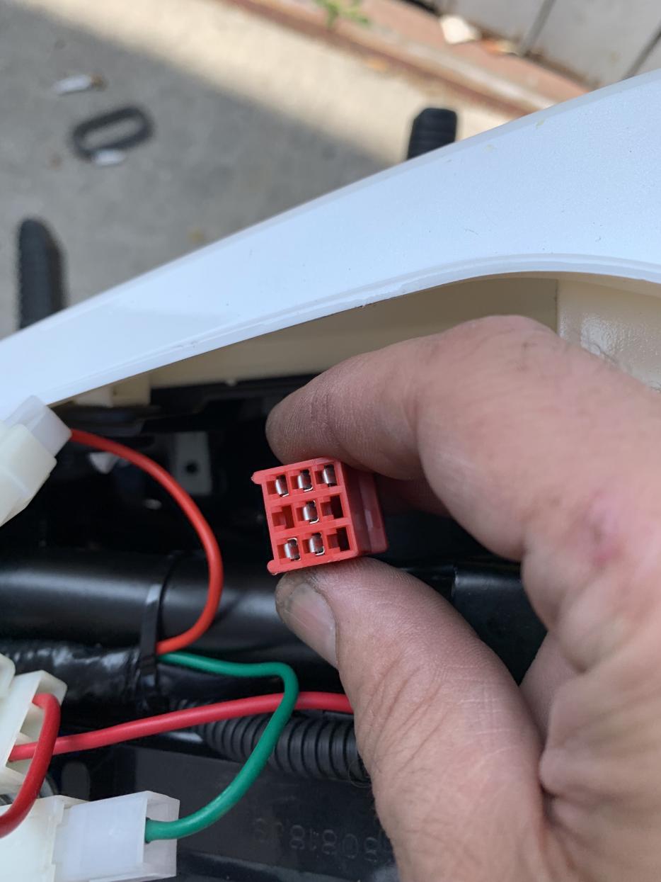

Hi,
New here and in a bit of a bind here, I just finished assembling my new BD125-10, and tried to start and it was a no go, no dash lights no turn over no nothing.
I looked under seat and found this adapter with nothing attached to it, does anyone know where the other end of this is?
THANK YOU AHEAD OF TIME FOR YOUR HELP!

I do not know that bike or connector but I would check out the ground first.
It could go to a 9 pin cdi. I've never seen one but I know there out there.

Posts: 11,853
You should have another connector that plus into it. That looks like the main harness connector for the CDI. Take a picture of the wires so we can see what colors they are to narrow it down what it is for.

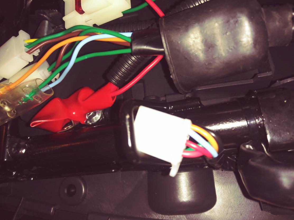

Cruising the forum and found this problem and decided to see if I had the same problem...Yup.. and the ground connection from the negative battery terminal was not connected.

Test Plug.
JerryHawk mentioned it's probable use and my middle photographs show that along with the ground connection (green wire) on mine was also disconnected.
