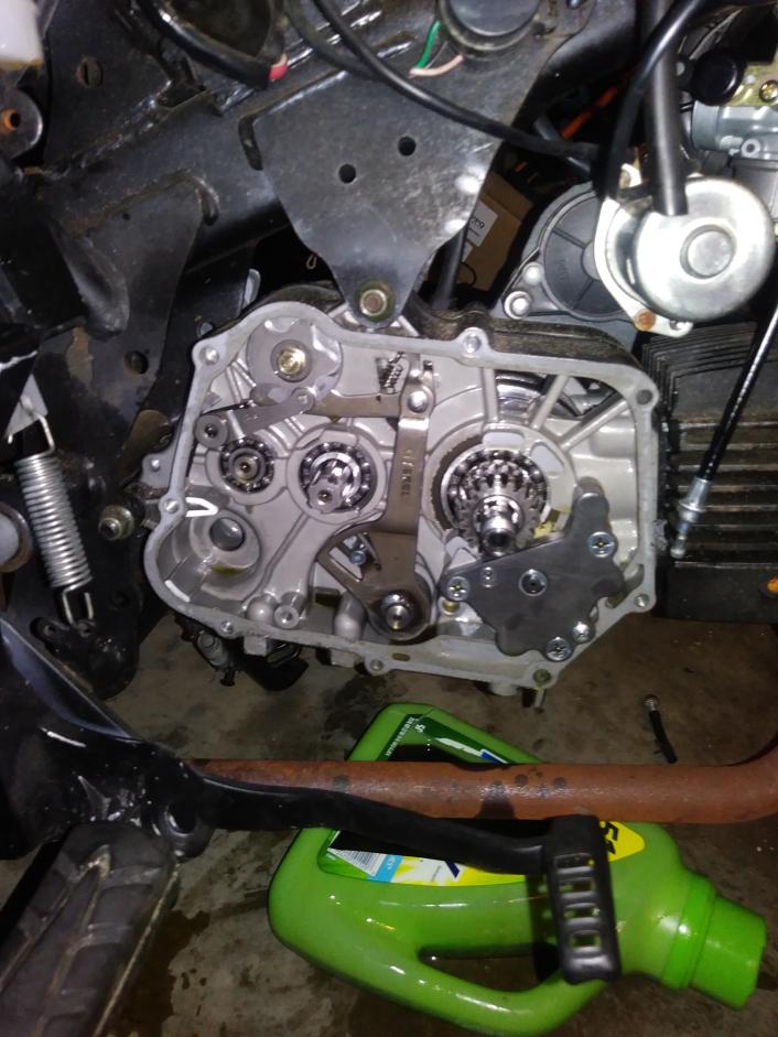

I ended up doing some work, got the bike to run well enough (bogged at midrange) and once warmed up I drained the oil and popped off the trans cover.
The nut that holds the clutch basket on was loose, only 1 tab of the star washer was engaged on the nut. This is the only obvious issue in there. Nothing looks broken or bent. But I'm new to clutch/shifting trans...only worked on mowers/scooters so far. So I don't know if the clutch basket nut being loose would cause the issues it is having or not. I guess it could cause it to be slightly engaged even if I have the clutch handle in and the cable adjustments right. Not sure why it would cause hard downshifts.
I tried shifting the bike with the clutch off, it gets stuck at the points of the star. But I don't know if it should shift smoothly with the bike not running or not anyway.

I checked the bolt (hex head, under where the shift indicator switch would go) at the other side of the shifter shaft and it is tight.
I made a video showing what it does. Note that the bike will shift up just fine when running, but downshifts are rough or require the engine/bike speed to be just right. Some of that may have been due to the clutch basket nut being loose, but I doubt it was the only issue and I believe the bike should be able to shift without the motor running (correct me if Im wrong!) You can see in the video that the shifter arm moves as far as it can, but the star/cam doesn't fully rotate and so it gets stuck at one of the points on the star.
