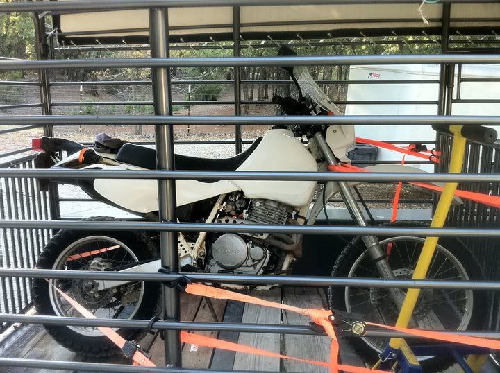

my new 1995 XR650L
Thought id post pics of my 95xr650l
mods include 13//45 sprockets
5gal tank, full street legal,de-smogged,race exhaust
it has 20k
hope the pics work

Wonderful deal! The bike does look great and was thoughtfully modified. You were saved a lot of time and money by the previous owners. :P
Spud will fill you in on more details, like a 650R countershaft sprocket.
Old 08-09-2011, 12:06 PM   #4
Good score!
It looks like someone has swapped out the metal tank for an XR or Clarke tank.

You got a great deal, Luke! Thanks for posting the photographs. It appears to me you got an IMS, 4.0-gallon fuel tank. You also got a nice windshield! I suggest you get some fork boots, or seal savers for your forks. I also suggest you examine your countershaft splines; if you see even a hint of rust, the splines are being worn down. :( I encourage you to switch to a wider, XR650R countershaft sprocket.
http://www.4strokes.com/forums/topic.asp?TOPIC_ID=32542
A 13T/45T sprocket combination should work well off road, even with your size, Luke. If you go with a 13T/49T sprocket combination, you will be able to pull stumps with your XR650L! 8O Most of us are using a 14T/48T sprocket combination for off road riding. This sprocket combination is numerically equivalent to the 13T/45T sprocket combination you currently have installed on your bike.
It appears you have the stock exhaust; did you get a different, separate muffler with the deal? You will probably want to do Dave's carburetor modifications to your bike; here's the link.
http://www.4strokes.com/tech/honda/xr650lcarbmods/
