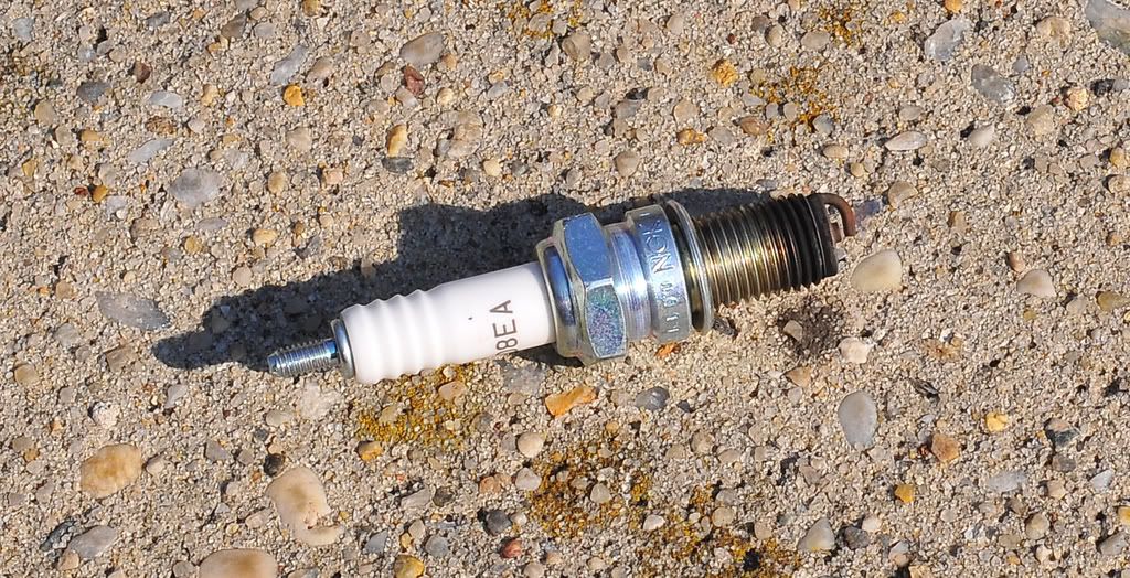

Iron, I'm going to take a pic first thing tomorrow. I think it's running good when its all warmed up. Strong pull (but I dont have anything to compare to so maybe it could be stronger). I dont smell anything funny after riding etc..
We'll see after I pull the plug and snap a pic. I'll post it up to see what you guys think.

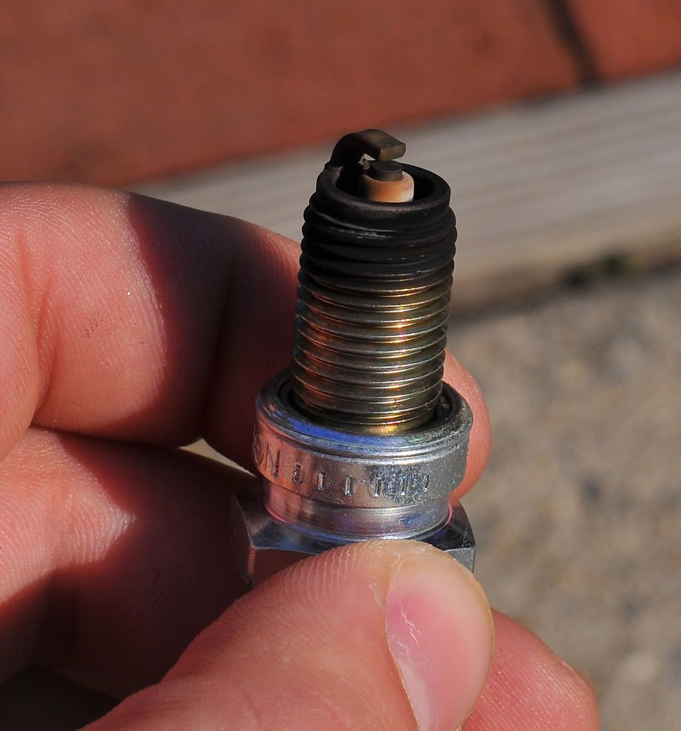

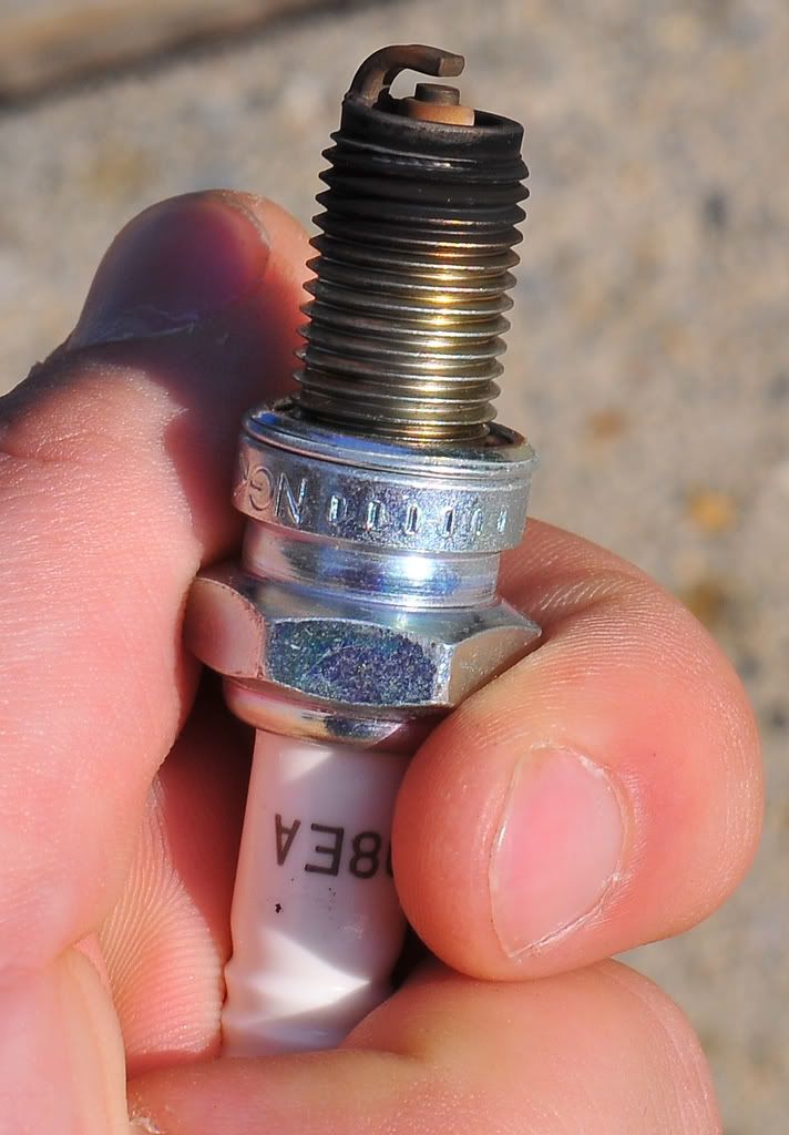

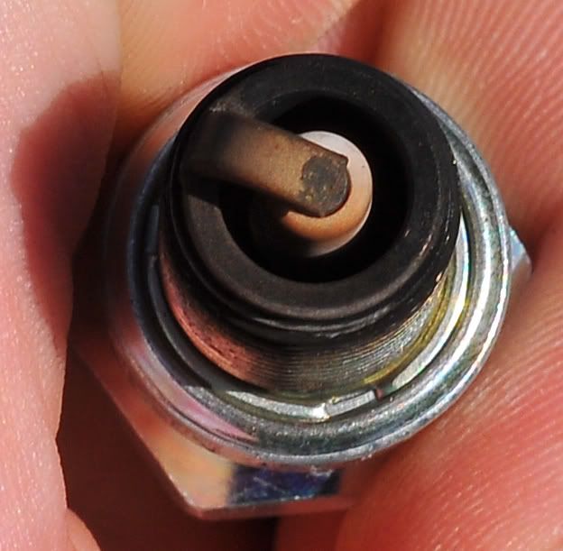

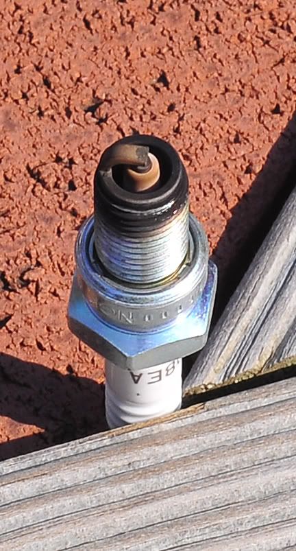

Ok! I've got some pics. these may be very large but I wanted to give you guys as much detail as possible. Please let me know what you think. Also, Ironfist - thanks for the free tests. Im going to give them a try tomorrow. I got kicked out of some private land I was respectivly riding on. I didnt know I had gone that far. Anyhow, without further a due. Your thoughts please:

AZ200cc 11-01-2008 02:45 PM
http://www.totalmotorcycle.com/maint...sparkplugs.htm
Might help
warrior91 11-01-2008 04:27 PM
looks fine to me.
I always try to picture the color of a jersey milk or hershey l chocolate bar.
If it looks like chocolate then fuel mix is good.
However try a throttle chop after riding around for a minute or 2 for a good color check.

That's a good plug color, (in my book) but in the first pic you can see a black depost. I'd clean that up with a bit of fine sand paper, re gap and stick it back in. For the price of a single plug you could replace with fresh. I expected to see a whiter tip by what you were explaining, but lets see what the tests show.
