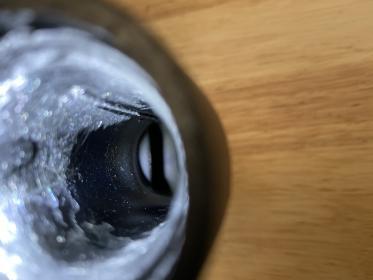

So I pulled the aftermarket exhaust off and was getting ready to bolt on the stock unit. I took a look inside and decided to clean up the welds a bit. After I was finished I took another look inside. There’s a huge restriction at the first bend. I could reach it with my index finger. Has anyone attempted to grind it out? I assume the opposite side will have the same restriction.

Is it a crimp from the bend?

That’s what I’m thinking. Very restrictive and I’m sure it’s not the only one.
That's how the exhaust looked on my X22R before i ground it down.
