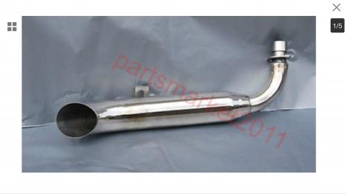

I have a 1999 Buell X-1 with a race kit. The exhaust on it is similar to this one:
It’s pretty simple. There is another member on here that sold some Vaders with this exhaust.
Let us know what you decide to go with.
Attachment 16507
https://www.ebay.com/itm/Honda-Z50-E...4AAOSwb3NZutjf
Attachment 16507
This is the one I went with for my zs190. Showed up yesterday. Cant wait for it to be up and running.
