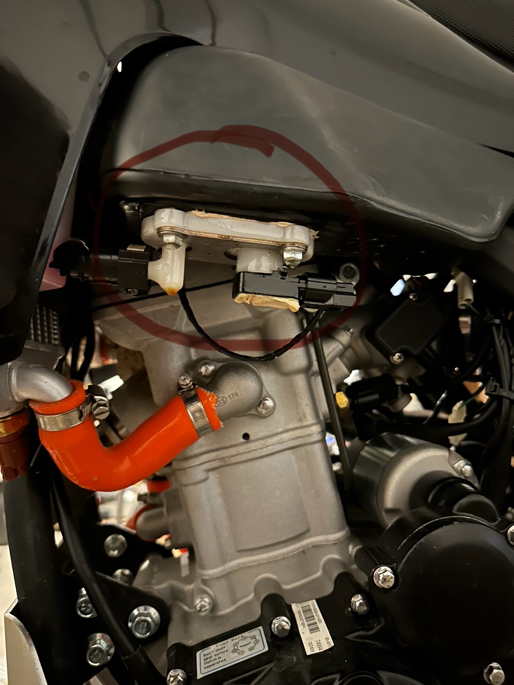

I’ve been having an issue with leaking fuel from the time I purchased the bike and I believe the leak has gotten progressively worse. I finally went out and got the bike plated and now this leak is causing me to have to wait to really go out and enjoy riding it. I believe the culprit is the underside penetration for the fuel pump. It’s leaking pretty freaking bad now. I’ve reached out to PSM with the requested photos so let’s see what solution they come up with.

Is that some sort of a gasket between the tank and pump?

The tank is leaking because they use a gasket and some kind of white sealant that isn't designed to work with fuel and it's additives.
https://www.aircraftspruce.com/catal...ezturnlube.php
https://hylomar.com/product/universal-blue/
Scrape all of the white crap off, don't damage the gasket and then reinstall with either of those products. I used the EZ turn when replacing my fuel pump, no leaks and I have used it on plenty of carb bowls to stop old gaskets from leaking.
